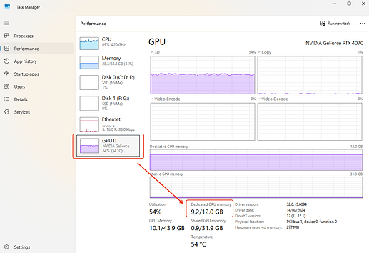

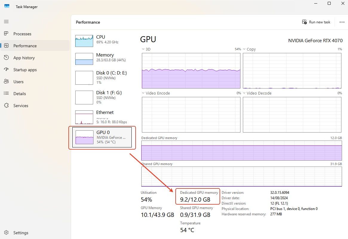

How to check the VRAM consumption of the current project file?
When used without proper organization by layers or groups these assets could increase VRAM / GPU consumption leading to crashes and error prompts such as the following:
