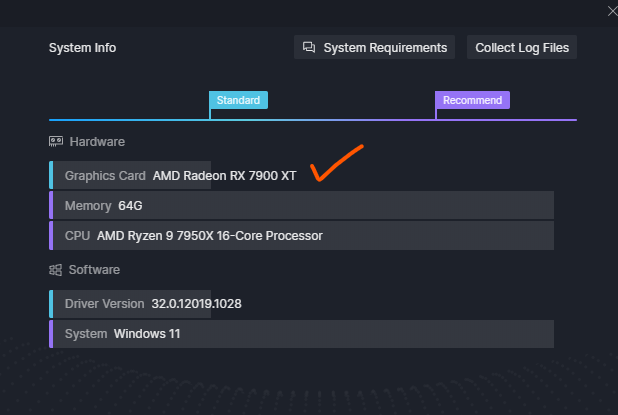

I think i might have found the issue - When collecting the logs on the hardware - the system shows that it picks up my onboard motherboard GPU. Maybe it is trying to render but it is not using the main graphics card, instead it is using the onboard card? When rendering on my laptop it works fine because it has only one card? Might this be the issue? See screenshots attached.
Screenshot 2024-11-18 233934 AMD 2
Hi
Please can you show this page in your Device Manager, and please try disable the AMD Radeon™ Graphics card. Restart to check the result. Thank you.
I got it to start rendering - Crashes and freezes at 95%. D5 Render is picking up the correct card now…but freezes
