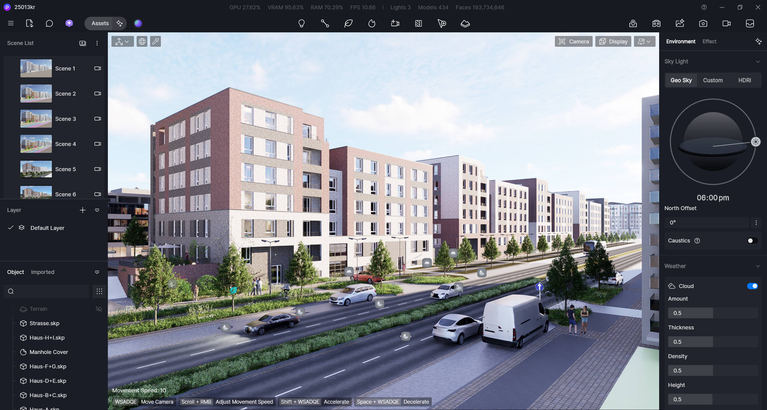

Scene without vegetation when I load it via the launcher!
**D5 Render Version:2.11
**Graphics Card: RTX 5090
**Driver Version:580.88
**Issue Description: Scene loaded from the launcher without vegetation, from D5 render with vegetation.
Hello,
loaded via the launcher, there is no vegetation except trees.
If I skip the launcher and load directly from D5 Render, everything is OK!
Strange!
Bye
Andreas

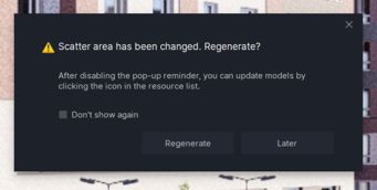

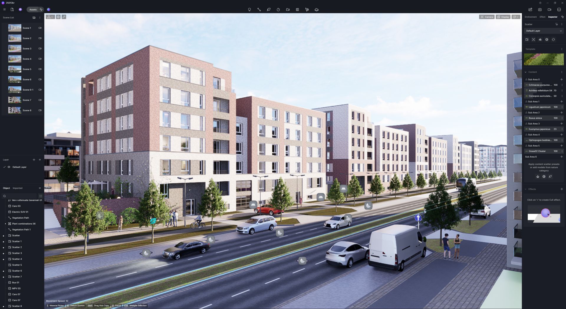

Hello Clov,
loaded via Launcher:
When I selected a scatter area via the list, this message came up:
Scatter_Area_regenerate
This allowed me to restore many scatter areas, but
not all areas.

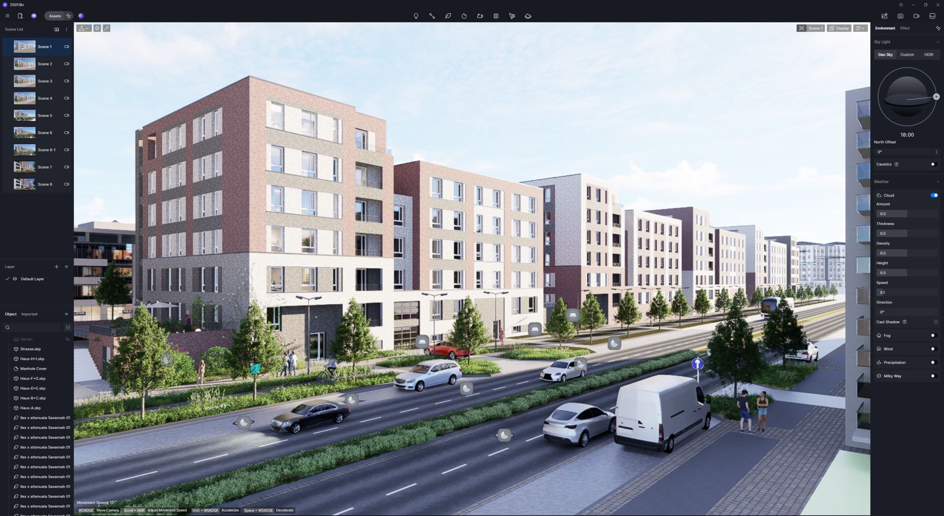

Loaded directly from D5:
No problems, verything right!
