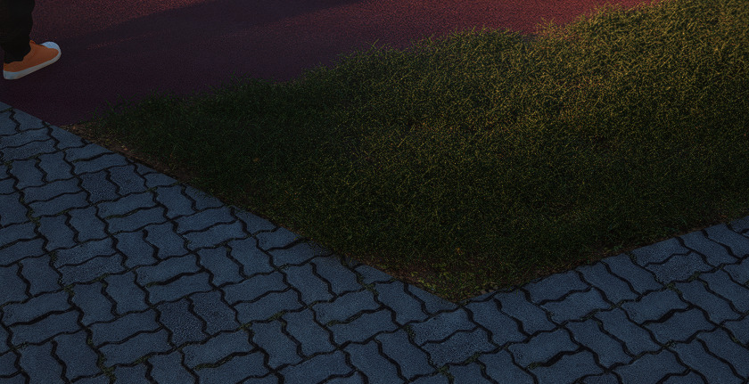

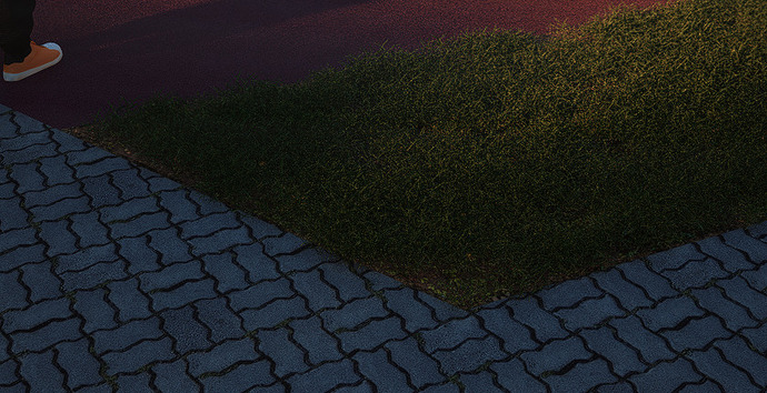

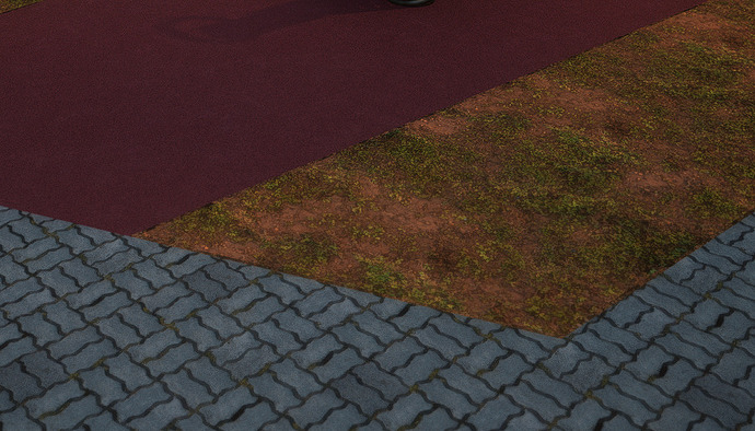

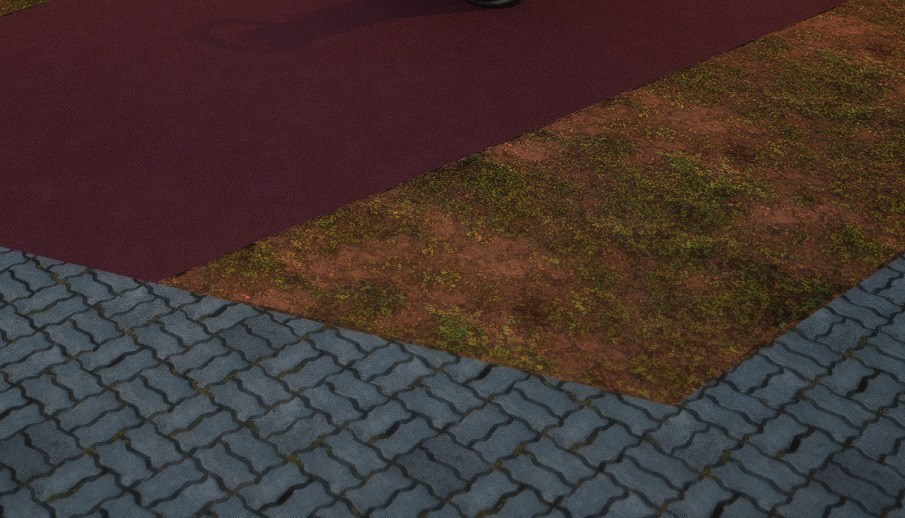

Hi there
Have the same problem. Whether I open D5 from the file or from the sketchup. Scatter looks like that
and I cannot regenerate it.
I see when I open file, scatter works sometimes, but when I open one of my video clips it disappears. And whe I click on other - then it shows again. But again when I click on previous clip it disappers. And it is not possible to show or regenerate it. Visibility is also on. I see that it works on some clips and on others not.
