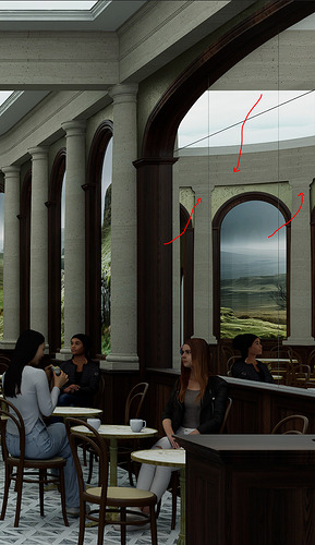

Here is the stone in the mirror with no emissive ceiling:
But when I make the ceiling emissive, the stone looks completely flat:
These are my settings:
In this image you can see the emissive ceiling makes the green reflection shadows very light and also for some reason the white paint on the crown molding has turned sparkly:

Thank you. With clay model and emissive light, things get even weirder. Why is the mirror so dark and why is everything beyond in shadow?

  4. Shadows being cast on mirrors like:
