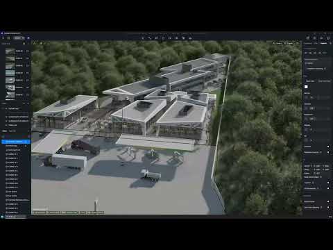

I recently upgraded my RTX 4090 to RTX5090. I followed the steps described to activate DLSS 4 as indicated by the team. It turns out that when opening the projects, I noticed that when I scrolled through the projects, blurs appeared on the screen, a kind of watery effect, as shown in the attached video. Is this normal for D5 DLSS4? I noticed that the larger the file is, the more blurs appear. But it basically happens with any project file. See the video below the screen.
I did a clean installation of the STUDIO drivers, the version I am using is 572.83.
D5 Version 2.10.1.0579

@Clov Yes. It only occurs if DLSS is enabled. If I check the CLOSE option it stops giving this problem. But the frame rate drops.

We apologize for the inconvenience this issue has caused. This is currently a known issue, and we are actively working on optimizing Frame Generation in subsequent releases. Your log files will be helpful in the process. Thank you.

Yes, this problem only happens in the preview window. The final render and animation are being generated without problems.

I apologize for the inconvenience. For now, please disable Frame Generation (DLSS 4) in D5 Render.
