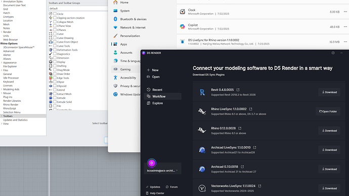

Rhino LiveSync not showing up after install
After frustrating experience with 2.11, I’m trying to reinstall 2.10.
https://forum.d5render.com/t/dont-install-2-11-its-a-mess/60355/5

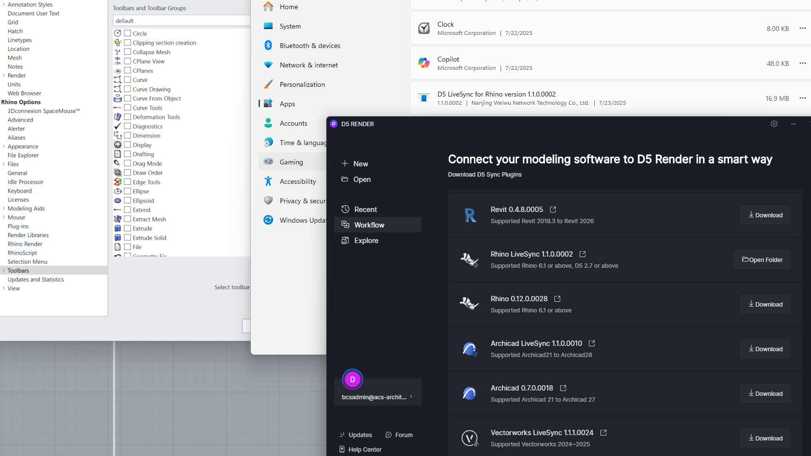

2.10 is installed, but LiveSync for Rhino isn’t working.
I’ve uninstalled and installed again several times and rebooted the computer, but it’s not showing up in Rhino Toolbar or Plugin even though the computer thinks it’s installed.
Lost really serious work time.
Another issue with 2.11

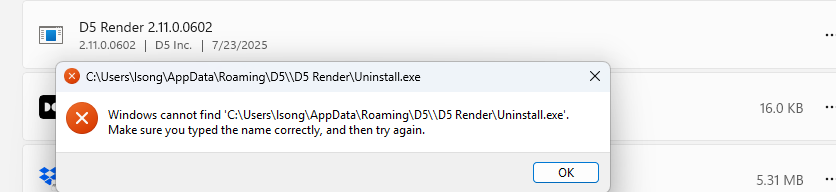

Even after uninstalling using D5 uninstall exe, it still shows up in Windows Settings Installed app. It doesn’t even properly uninstall itself.
I was trying to delete everything related to D5 and try again, but 2.11 is refusing to go.
User solved the issue by:
I finally solved the issue by installing LiveSync “only for me” not “for everyone” even though D5 recommends installing “for everyone.”
