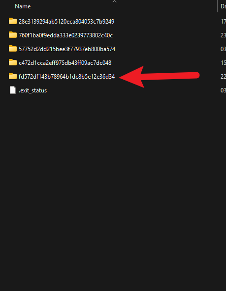

Hi @matipenon
There are several folders with usr.ini files under the usr folder. Please try to check the last one.
  • Its contents should be similar to the screenshot i have posted, you can send a screenshot of it privately.

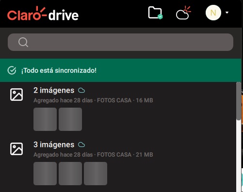

Hi @matipenon @veroalborghetti @ing.alberto.blanco @vizcabruno
We recently replicated the issue that was experienced by several users. Can you confirm the following:
  • Which Country/Region are you currently located in? By chance, from South America?
  • Are you an active user of Claro Drive? And is the application running while you were using D5 Render?
Uploading: Claro Drive.jpg…
Claro Drive
Hola @Clov , es asi, a mi me solucionaron el problema los chicos de soporte de D5 (unos genios!!!), les paso info del programa que tiene conflictos con D5, se llama CLARO DRIVE (es una nube de la empresa telefonica Claro, soy de Argentina asi que puede ser que en Sudamerica pase lo mismo si la usan).
No hace falta desintalarla…con quitarla de la Barra de tareas cuando usamos D5 ya funciona…despues la pueden volver a activar y sigue todo normal.
Quiero agradecerte a ti @Clov y espero sirva de ayuda para otros miembros!!
Saludos

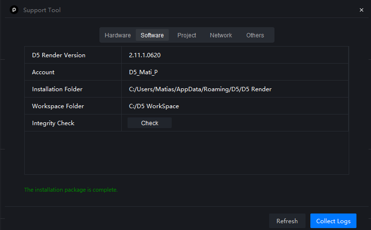

May we please confirm if the problem is still occurring on your end? Recently, we have received similar reports from other users experiencing crashes when saving files, even without using the Claro drive. Our team is currently monitoring this issue closely and actively working on a fix.
In the meantime, we kindly ask you to collect your D5 log files using the D5 Support Tool and upload them to WeTransfer. Once uploaded, please send the download link to support@d5techs.com so we can further investigate your case.
Thank you very much for your patience and cooperation.
