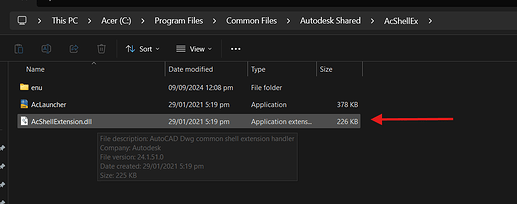

Please first confirm: you cannot import models, save/save as the current file normally, and D5 will crash.
If so, the problem is caused by the Qt pop-up window conflicting with other DLLs.
You can try:
  1. Exit Claro drive or other cloud storage
  2. Locate and Rename the Autodesk DLL/plugin
    Could not reach server (timeout). [127.0.0.1:12121], live sync abort - #16 by ela
  3. If your device has none of the software above, please collect a log file and send to us. Thanks.

I’ve tried to rename the file, and I don’t have any cloud storage running, but the problem is still persistent. Every time I tried to save (Windows Explorer Open), the app crashed.

I think if you see that file you must remove it, the d5 render will works well
thank you very much , it worked for me
