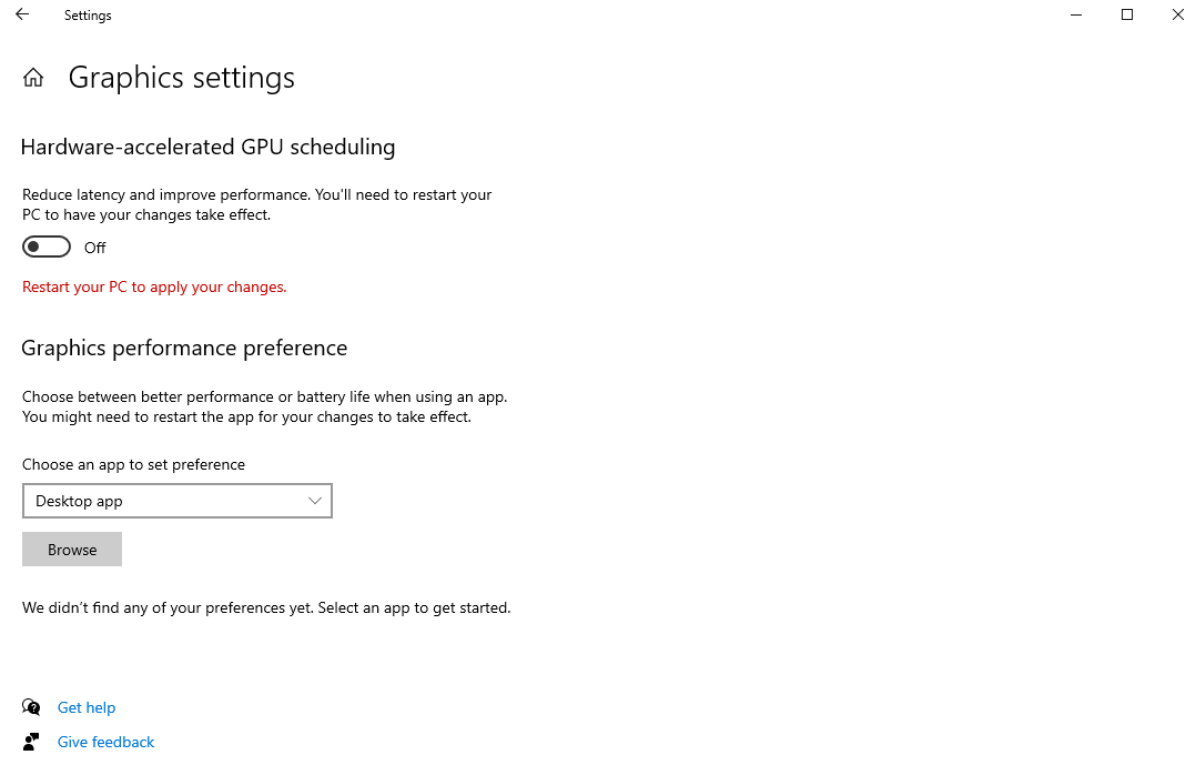

Sorry for the issue. If the crash happens in every scene file on your end, it would generally be an issue with your PC environment. Here are my suggestions based on your situation and troubleshooting already undertaken.
Please firstly check if you enabled ‘Hardware-accelerated GPU scheduling’ in graphics settings, try to turn it off and restart to see the result.
