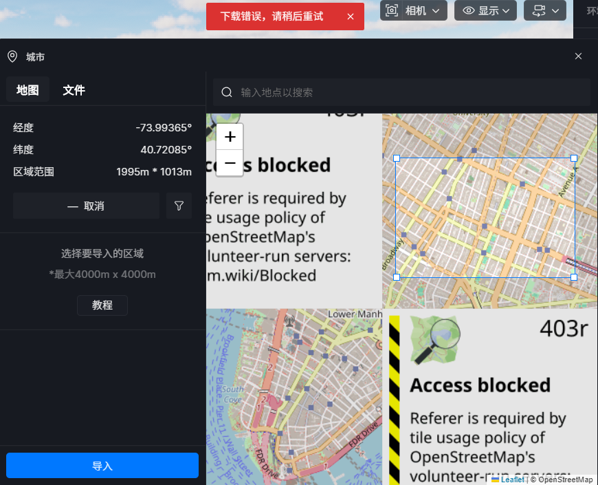

Hello, I’m also encountering the same problem. This function isn’t working properly; it keeps showing “Download error, please try again later.”

The “Cesium download error, please try again” issue is primarily caused by network instability, especially for users in mainland China (CN), as Cesium services rely on overseas servers.
  • Can you confirm if you’re in CN using Cesium?
If so,
  1. Use a stable overseas network (via VPN) when downloading Cesium data.
  2. Restart D5 Render: this can sometimes clear temporary cache errors caused by corrupted tile downloads.
  3. For persistent issues:
    – Clear local Cesium cache (stored in %LOCALAPPDATA%\D5 Render).
    – Ensure your Launcher and D5 Render are updated to the latest version.

I am using Cesium in Taiwan.
I am not using the mainland China version; I am using the overseas version.
I am only using Traditional Chinese.
D5 Render has been updated to the latest version 3.0.1.
I would like to ask where the Cesium cache is located?
Thank you very much for your reply. Grateful.
Hi @te1650699
I apologize, please disregard my suggestion regarding the cesium cache. Just to be sure, were you able to set up your Cesium Token correctly?
Let me know of the results once you have remodified your cesium token.
Thank you very much for your professional solution.
It worked.

  • Cesium and City Generator belong to different categories. The link I sent you provides instructions for making Cesium work. There’s no need for a token in City Generator since it is directly based on OpenStreetMap (OSM).
