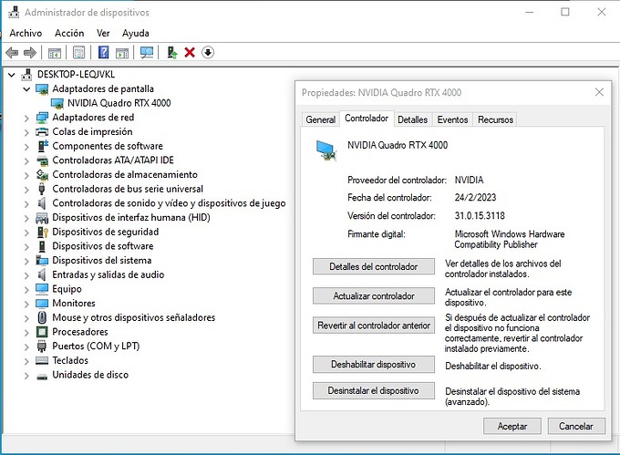

  • Installation of both new and old drivers for the graphics card (Quadro RTX 4000)

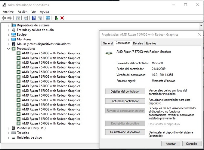

Until today, I still haven’t been able to make it work. Just 3 days ago, I changed the motherboard, CPU, and RAM. I’m leaving the specifications. I still can’t get it to work, even with a brand-new operating system installed from scratch, fully formatted.

Can you also share this page of Task Manager with me? What’s the capacity of the ‘dedicated GPU memory’? Thank you.
Thank you Leah_li for your collaboration. I leave you attached the image of the details of my GPU.
Greetings and thanks!

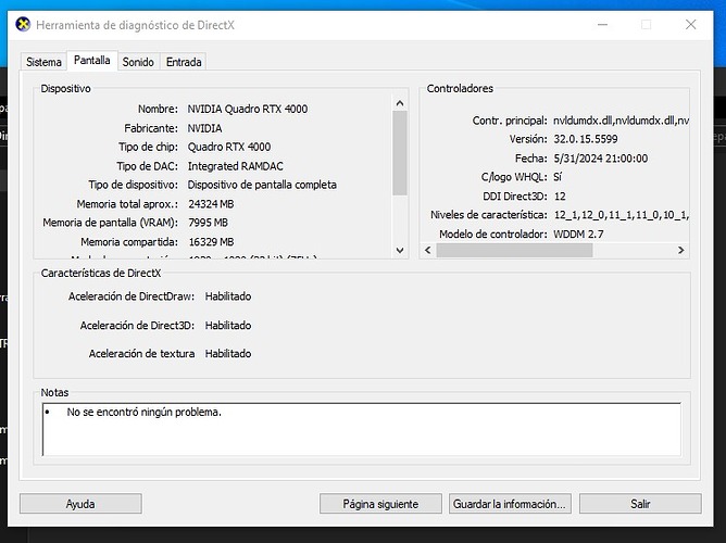

Please download the DirectX Diagnostic Tool DirectX
Please show me this page ‘Display’.
and then click this button to collect a DxDiag file and send it us.
Leah! I atach you the files!
Eternally grateful for the help
DxDiag.zip (12,2 KB)
