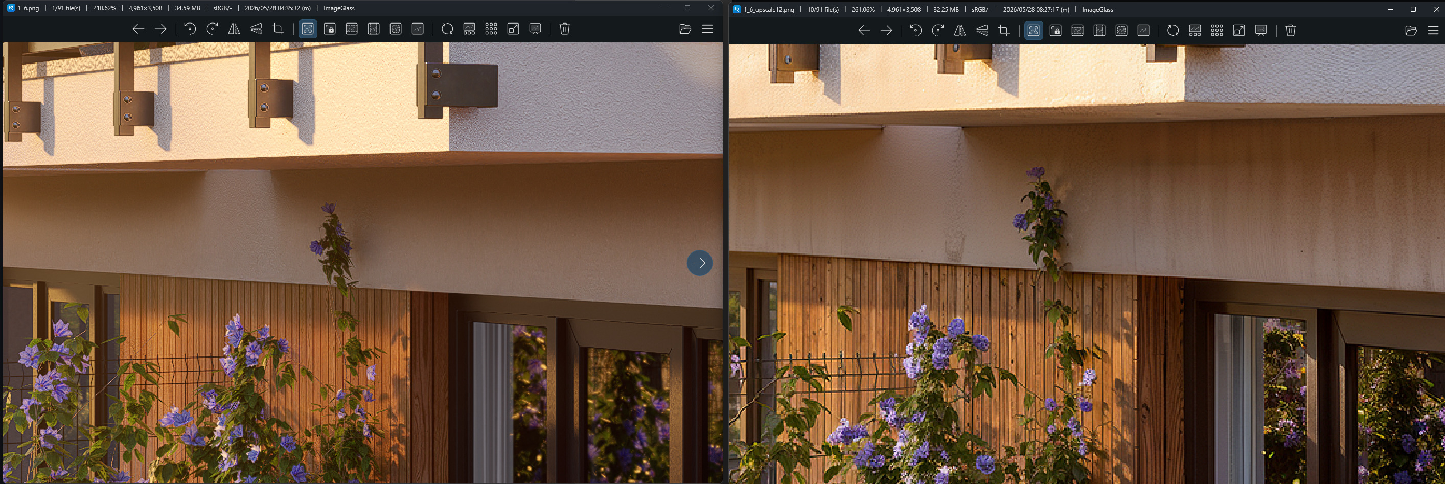

AI Enhancer buggy if using reverse method
AI Enhancer is buggy if using reverse method. Reverse overwrite all previous selections.
Also even lowest values are too strong for walls
Update :
Selections doesn’t work at all even without using reverse layer. This is why I did mixing in Photoshop before. I was scared that this is another feature that didn’t work as expected.
Do you know why selections doesn’t work ? Because you have again totally buggy interface that is locked while something is selected ! Interface team works like saboteur here…

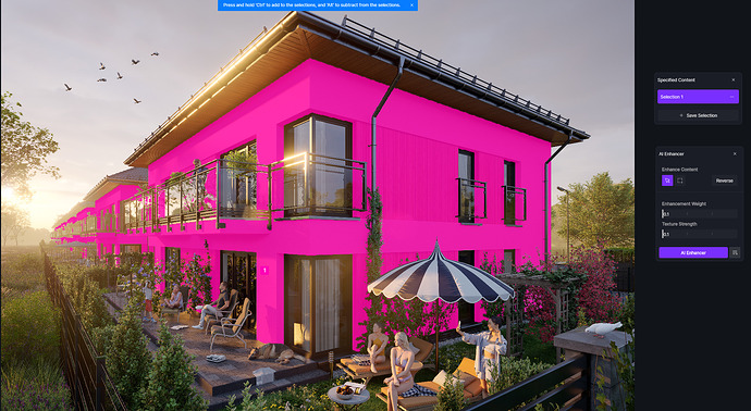

To clarify, did you enable this AI Post Channel map?
Just some minutes I will send it. Yes I had enabled all channels. I didn’t have problem with selecting parts of the scene. They were selected perfectly. Problem is with AI enhancemer selections and UI sliders. Whether you set in AI sliders per selection it doesn’t work - all selections use maxed AI settings.

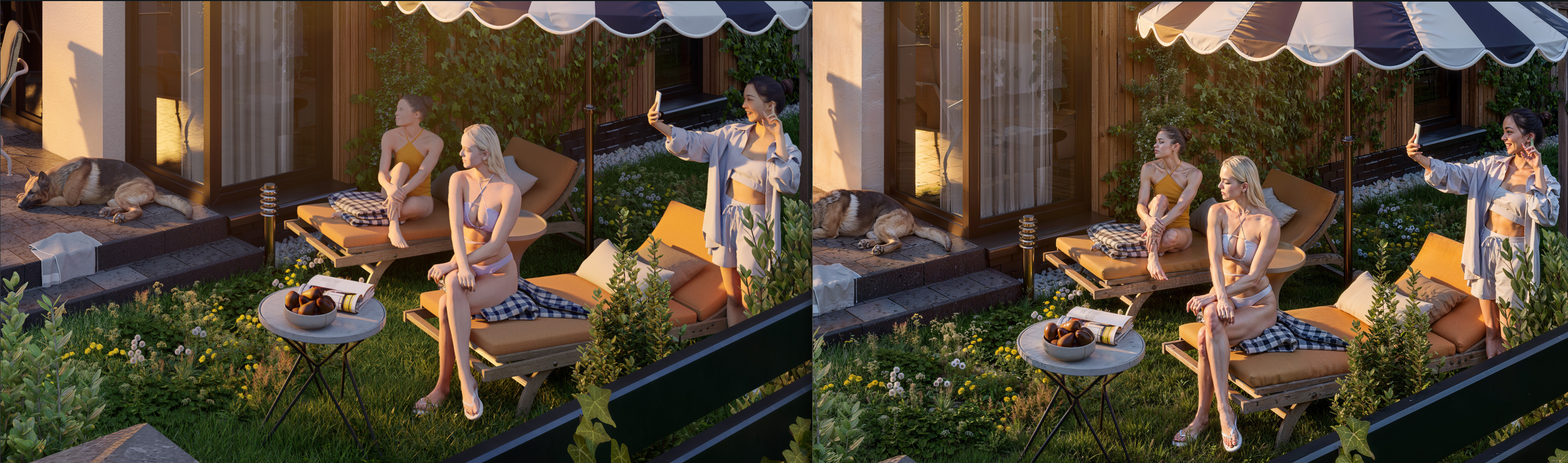

I used selections like 25% for walls and wood panels, 50% for people and reversed 90% for the rest.
Generally it looks like all of the image was generated like 100% AI without taking into account selection strength. It works fine without using selections.
But I tested without reversed selection and it works the same - only one change that all parts without people and walls doesn’t have applied AI at all as it should be.
Please see
People shouldn’t have the same 100% AI upscale than vegetation and walls/wood panels should have very subtle. They all have have max AI enhancement. Works fine without selections.
Walls and panels had 0.1
but :
Generally it looks super realistic but you know that if client want clear wall there is need to do additional job in Photoshop and if there is many views that cost time. Probably D5 introduced selections for that but doesn’t work. This is why I reported.

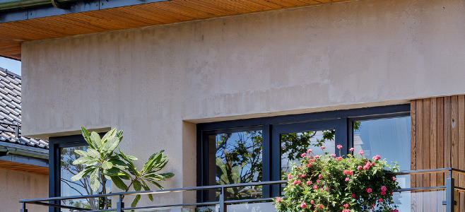

This is AI generated using lowest settings without selections :

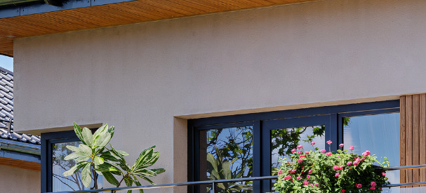

This is the same with selections set to lowest settings the same settings as above :
This is another advertised feature introduced near year ago that completely doesn’t work. So I surely that it was not tested. Everyone can see this in renders. I don’t think that it magically stopped to work after months.
As I said it looks like AI Enhancer works fine but interface is wrong implemented so selections doesn’t work.

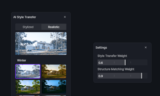

It looks like AI Style Transfer settings doesn’t work too. I don’t see any difference using 0.1 or 0.9

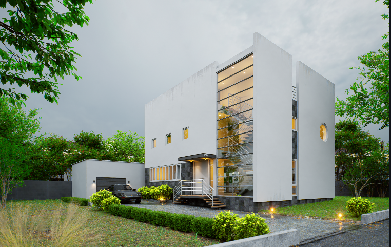

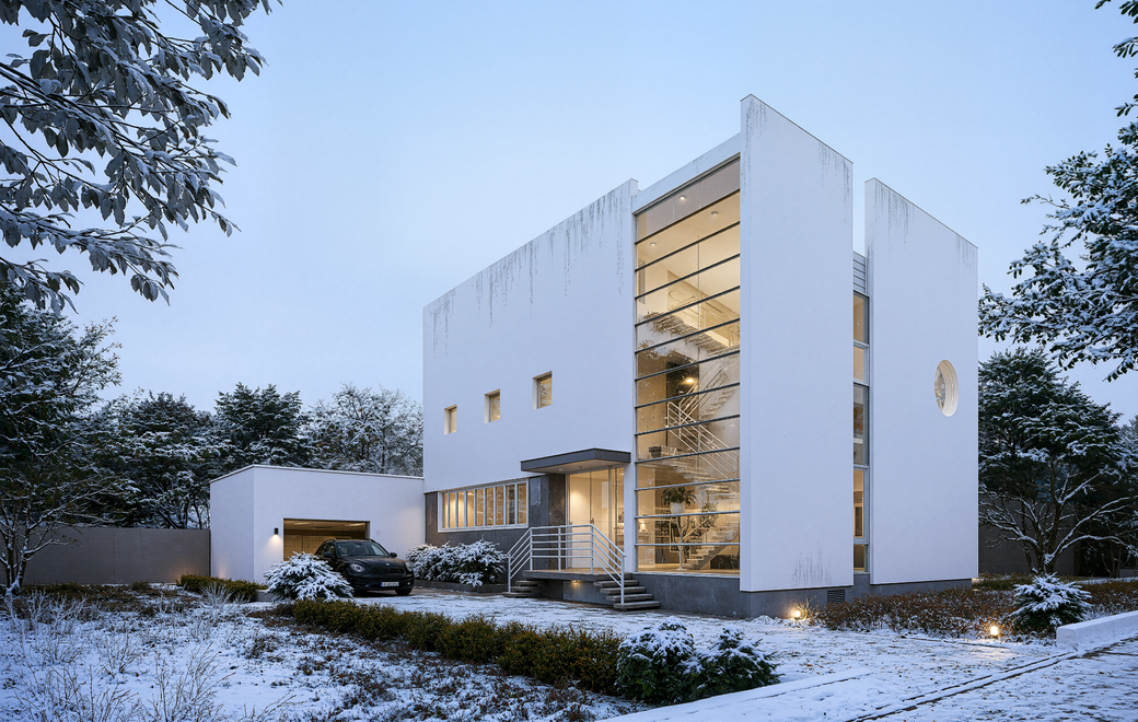

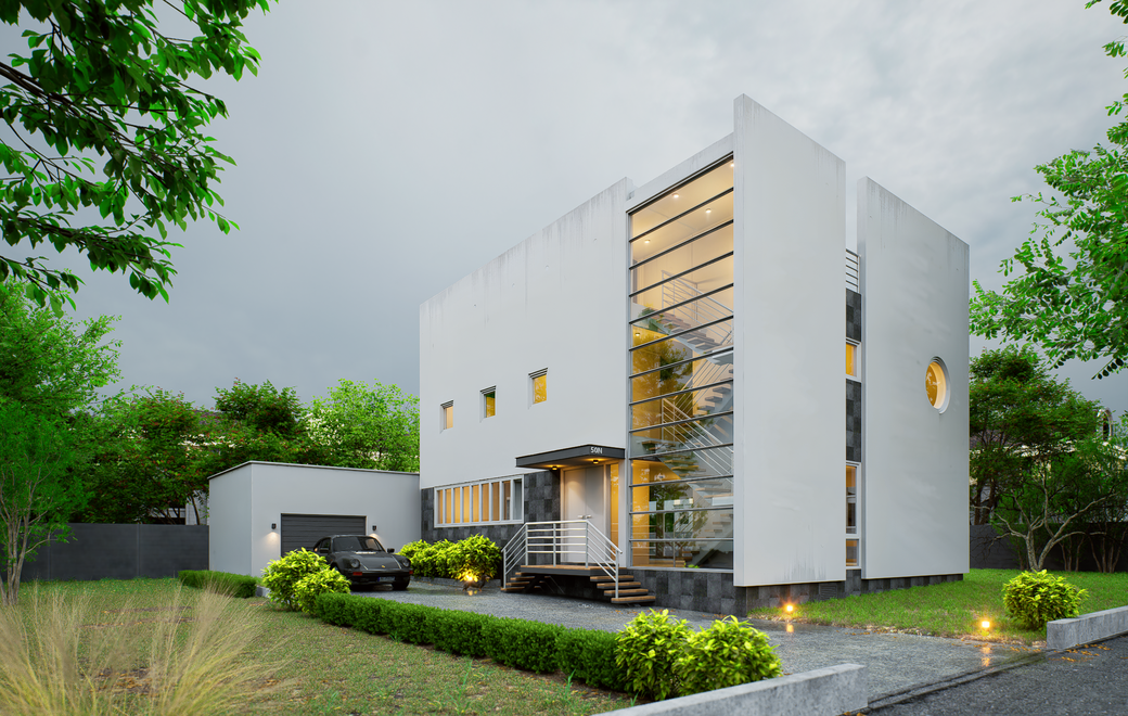

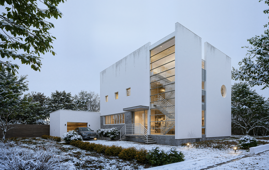

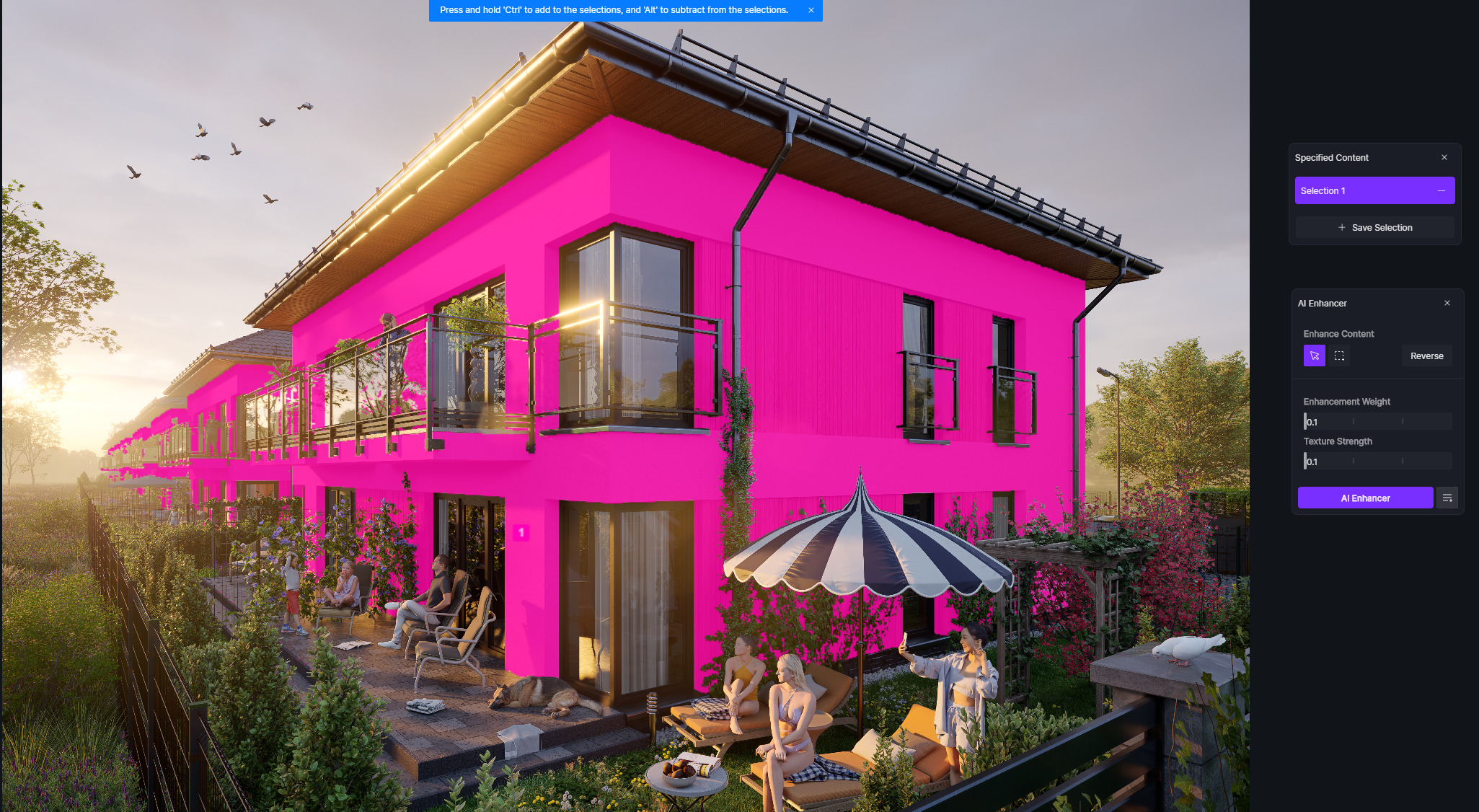

I have tested the issue you reported and found NO replication on my end. Although this has already been reported together with the images that you have sent so this may be specific to certain file/image only.
Results:
AI Image Enhancer (Selection): The selected surface is the building’s wall. Weathering on the surface is intensified.

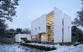

AI Image Style Transfer:
Hi @Clov, I see on your images that you have the same issue. Selected surface has the same maxed texture using all settings. Only difference is a sort of randomness pattern but intensity stay the same. Please test more complex wall structure like balconies.

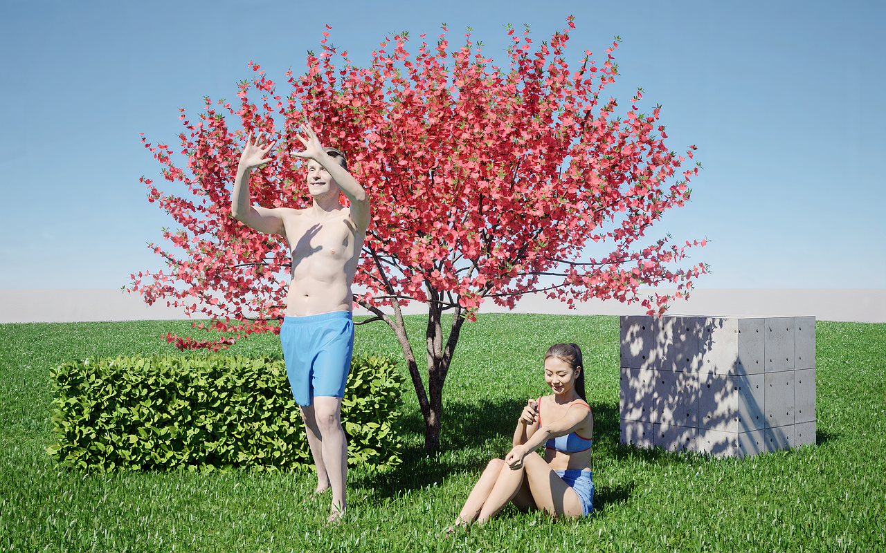

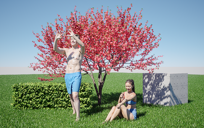

You have interesting form of testing. You tested plain wall which has dirt decal included by default. And you have only one selection - maybe D5 has problem with more than one selections. This is why you didn’t see problem. Here is real testing :
Without using selections - AI power and texture set to minimum 0.1 :
Man power and texture set to 0.1 as before, woman set to 0.9 :
You see problem now - all selections use maxed values - man has 0.9 the same as woman. Selections completely doesn’t work.
