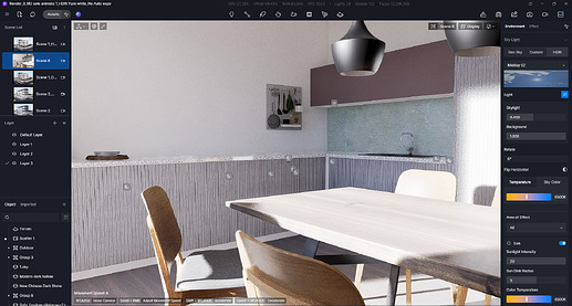

I tried everything you suggested. I think I solved it except for the light balls I get when I activate raytracing.

Thanks for sending your file and I have tested it. On my end, the visual results are quite different. There are indeed some unwanted light artifacts (balls) whenever I navigate through the model, most especially in dark spaces. These light streaks or artifacts should only be evident on preview window and the final calculation or render should be relatively better.
For reference, I enabled Super Resolution, FPS Booster, and Path Tracing in these screenshots.
  • Additionally, you can try to modify the parameters of these materials and lower their specular parameter and increase the roughness setting.
  • You may also want to try to reinstall D5 to see if there are any differences since the results on my end greatly differs from the screenshot you attached.
In preview I don’t have any visual problems either, but it’s in rendering that the artifacts appear.
