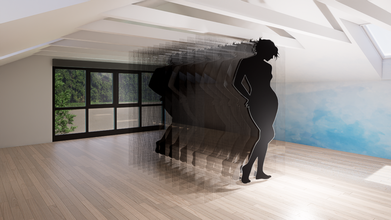

Hello. I need to put 8 printed curtains in sequence. The problem is that if i put the same opacity to all the curtains i can see only the first one. You can see the second one only because i increased the opacity. Another thing: the black in the image let see through but it is not intended. Any suggestions?

Thanks for the help. I tried but i had no luck. No matter the type of material. If transparency/opacity is the same they don’t work. Maybe i do not understand it correctly or the software can’t do it right now. I will use photoshop to fix it. Thanks for the time you dedicated to me

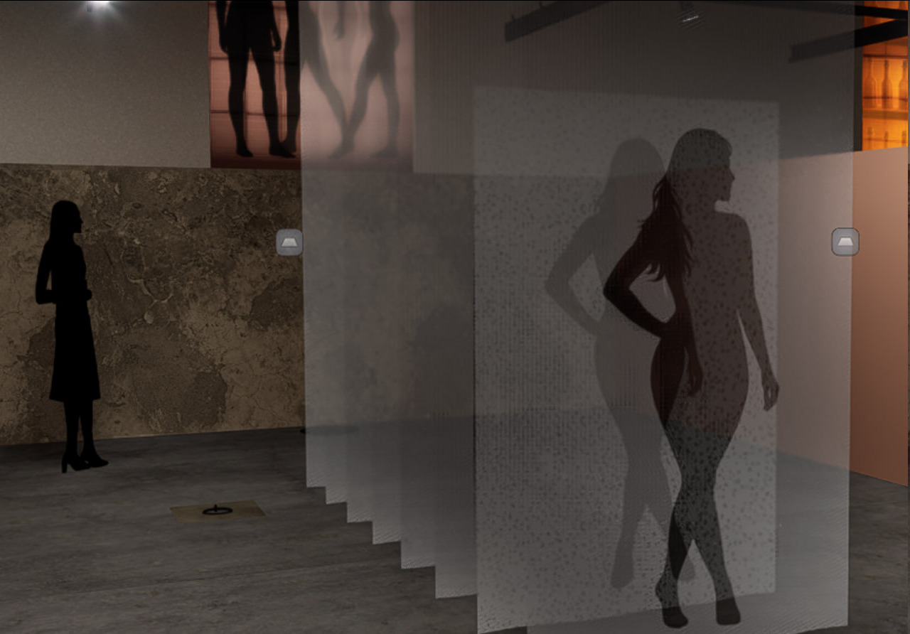

is that going in the right direction?
Looks cool! Yes, i was looking to something like that. I found a reference photo to let you see the final idea. For now the glass template looks the more accurate but still not perfect. You had to change the opacity/trasnparency of the different ones? Or you can use the same level/percentage for every figure?
Hello, The fabric and the woman are on different surfaces. Surfaces with fabric are transparent. Surfaces with the woman are alpha channels. This separation gives me more control over the fabric and the woman. The results might be better if the woman were also made of transparent material. Give it a try! bye, Andreas
