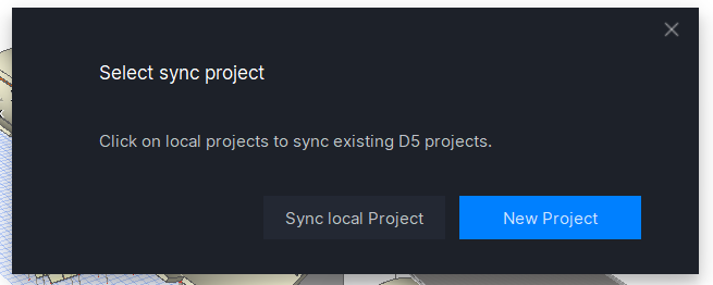

Hi @Langliid Sorry to hear you’re still experiencing this issue. When you start D5 using the plugin, do you receive a prompt asking to “Sync Local Project” or “New Project”? Normally, after saving both the D5 and Archicad files, D5 should automatically open the previously synced project without showing any prompt.

- I do not get the “Sync Local Project” prompt when reopening D5 via the Archicad plugin – it just opens directly.

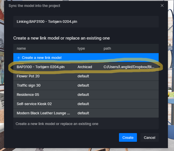

I get this promt:
But tried multiple times with different options. This promt window did not show up before i saved the .pln on my desktop.

Hi @Langliid
I apologize for the inconvenience. As for your workflow, I think working on existing D5 Projects linked to 3d Model (AC, etc.), it would be best to open your D5 File first, then proceed to activate the live-sync.
- You can also try to click on the BAP3100-Torbjorn 0204.pln then proceed to click “Replace” (This window prompt usually appears when the 3d Model file was opened first, then live-sync was activated)

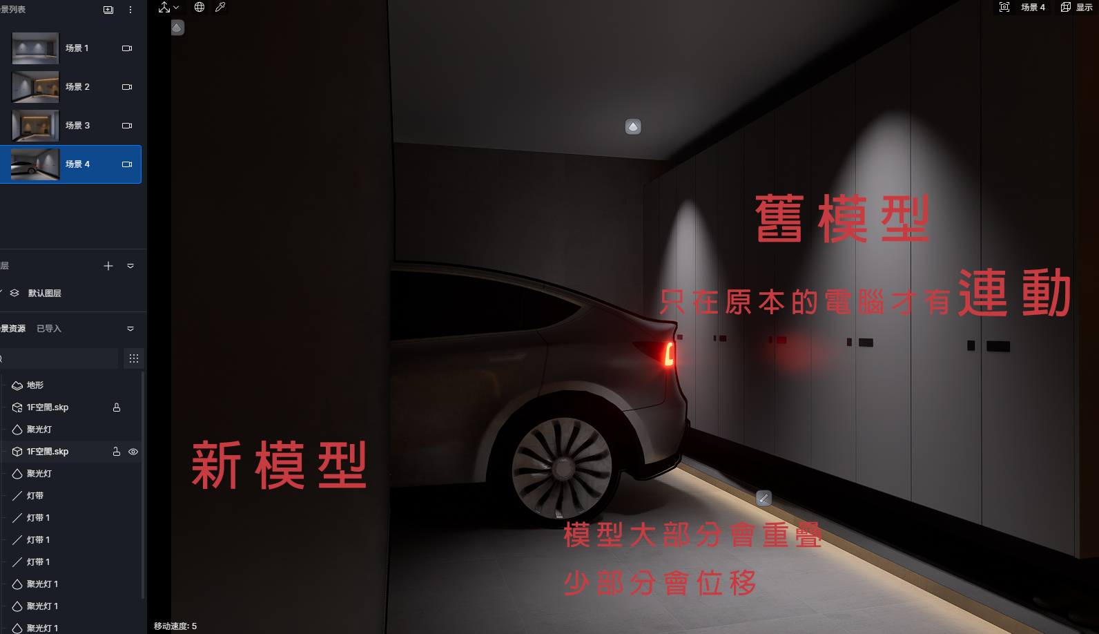

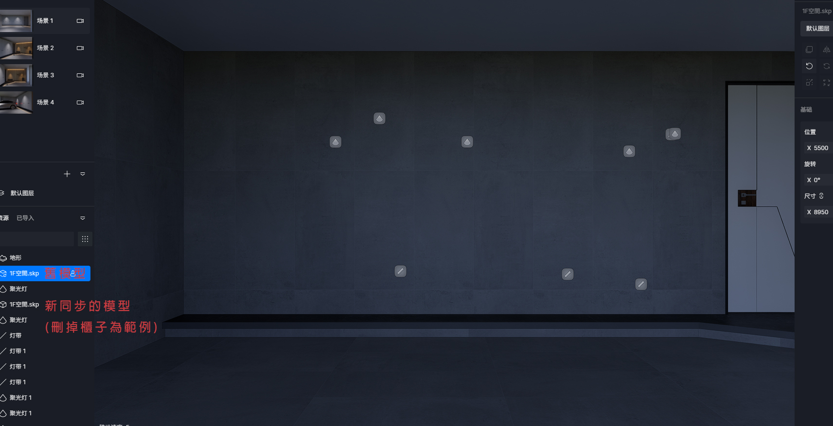

我們團隊遇到此問題很久了!!
都各自擁有一組不同的帳號,並在各自的電腦運作
使用步驟
Sketch up建模儲存雲端硬碟-D5同模型儲存地方,只要同事需修改並在自己的電腦開啟sketch up同步模型下載D5同步後就會出現模型重疊,重複的舊模型沒有任何連動,也無法更改!!
只能同步新模型,且重上材質,這問題確實困惱我們很久!!!

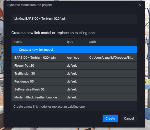

Hi @Clov,
Thanks for the follow-up. I’ve carefully tested the workflow you described:
- I open the D5 file first (the one with correct materials)
- Then I open the Archicad
.plnfile - I click “Start LiveSync” from Archicad
- I get the expected prompt to “Replace” the model
- I select the correct model and ensure that “Material” is checked
However, no matter how I proceed, D5 still replaces all the materials with Archicad’s defaults as soon as the sync happens. This includes cases where:
- The
.plnand.d5aare stored locally (not in Dropbox) - The file names match
- I select “Replace and link” carefully
I also tried completely removing the Dropbox version and rebuilding the sync from scratch – same result. It seems like D5 creates a new model instance under the hood and fails to inherit the previous material data, even when explicitly told to do so.
Is there any way to force D5 to maintain the material assignments from the open .d5a file when LiveSync is re-established with the .pln?
