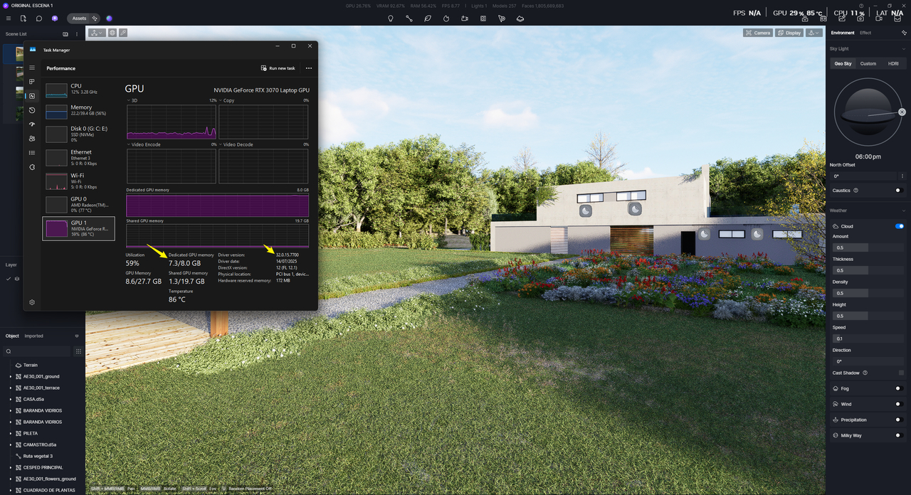

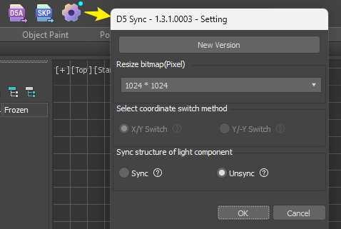

I apologize for the inconvenience. I want to clarify and ask for the following (please send a screenshot):
  • What is your Plug-in Version?
  • D5 Render Version or exact build?

  • For reference, I am using an RTX 3070 Laptop with 8GB VRAM; NVIDIA Drivers 577; D5 Render 2.11.1 Hotfix Version - No crashing
  • It seems like you’re still using an old NVIDIA Driver: 561.09 and 2.11.0 Version, if you can update your NVIDIA Driver and D5 Version, please do so and try again to check if the issue persists.
