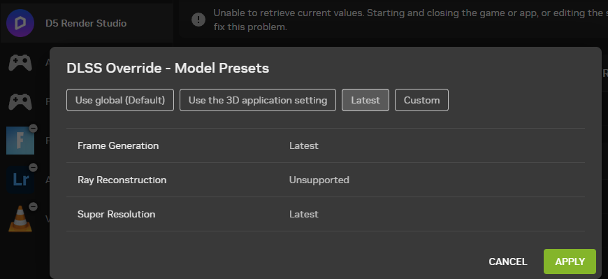

I found that it stopped flickering when I set DLSS version in Nvidia panel to “use 3d application setting”. Before I had - use latest :
I will test this more using default DLSS settings.
Still flickering, this is totally randomly, independent from any settings.
