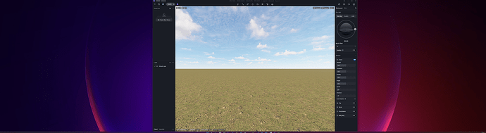

Great but please test it using reduced D5 window size like this :
It looks like it has big impact to trigger this issue.

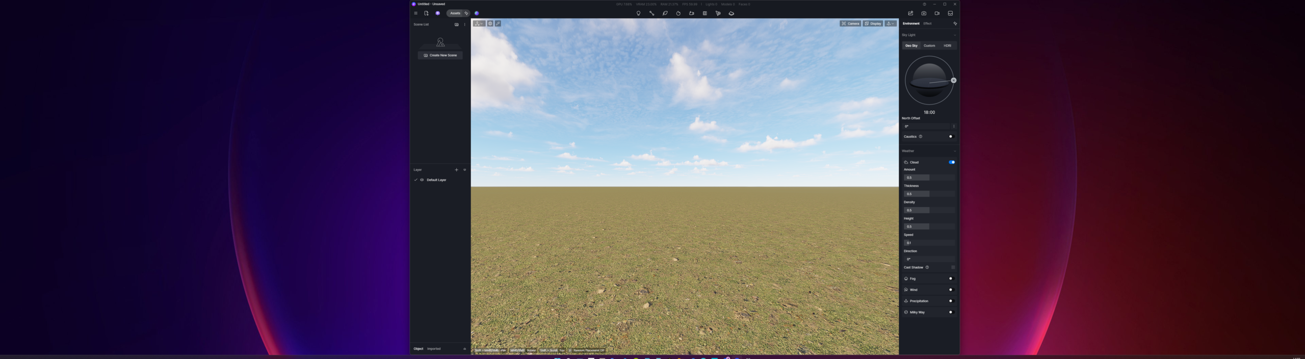

It looks like
makes that it works fine now.
I had turned this off before. So this is related to my ultra wide screen monitor which I described in this thread before.
