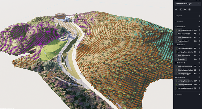

Hi,
I am having an issue with my scatters. After editing them, they disappear. I can still see them on objects and view their contents, but they are no longer visible. This has happened to all my scatters. When I receive the ‘update the scatter area’ notification, it fixes the problem, but I don’t get this notification often, and I haven’t been able to figure out how to manually update the area. I also use D5 Teams, so I have to use the D5 Launcher.
Can anyone guide me on how to fix this issue?

The issue mostly appears when I edit the scatter surface in D5 for example, when I erase or add more area to the surface. Also when I create a forest and make multiple edits to the scatter the trees in the edited scatter area disappear while the trees in the remaining scatter areas stay visible.
The solution I found is to click “Edit Scatter Surface” again and reselect the surface I want to apply the scatter to.
Other D5 Teams users on my team also have similar issues with scatter. Could this be because Im using D5 Teams on three different computers at the same time each synchronized with a separate Rhino project?
Unfortunately I cannot share the working file but I would really appreciate any help or suggestions you can provide.
