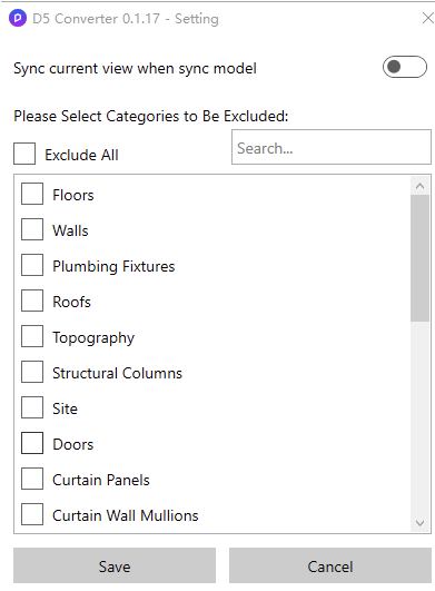

Can you guys explain how the Export and Separated functions work in the D5 tab in Revit? This video is 4 years old. The menu doesn’t look like that anymore.
Is it possible to set the setting to export families rather than categories before starting up D5? Or do I need to export separately? I’m finding it hard to link the model back in when I export separately. A video of that workflow is nowhere to be found.
Hi @hammad.moe1230
Do you mean this one? Basically, if you have some families that do not need to be exported, you can exclude them. If you need to update the model, i think you can do the same process and reload the model in D5 (this will prompt you to select the file)
