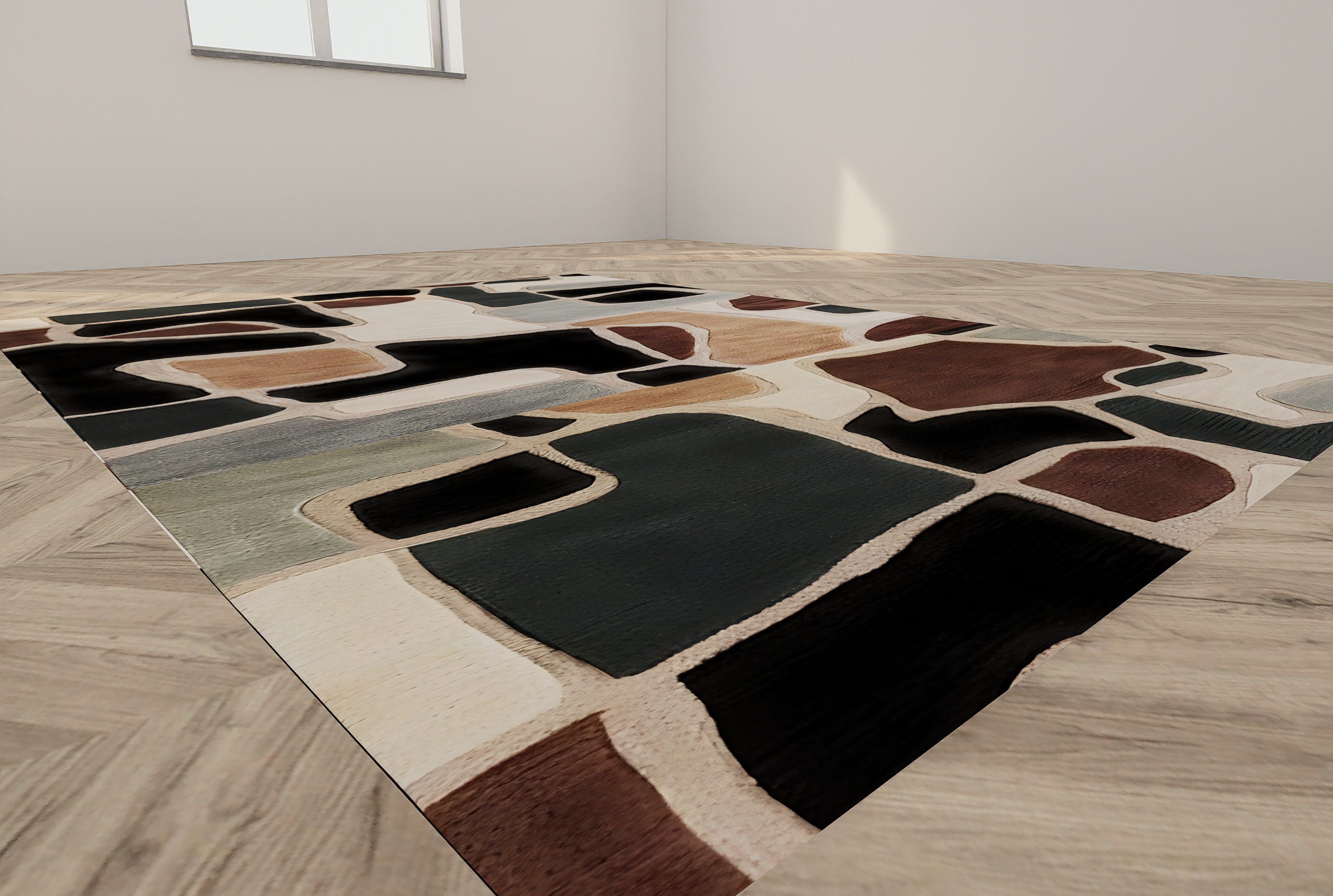

Hello, I am looking to find a way to improve the realism of the carpet within my interior scene. I have included a resized 4k render of a closeup shot of the current carpet I have inserted within the scene. I have experimented with various settings to improve realism although I believe that D5 is limited to flatter looking styles at the moment. If anyone can help, this would be greatly appreciated.
I would like to point out that when rendering a realistic scene, one component that looks unrealistic will make an entire render look poor even if the rest of the image is technically spectacular in quality. This is an unfortunate reality and I believe most visualizers understand this well.

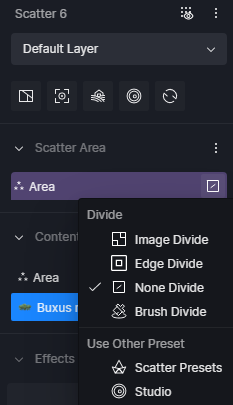

Hi @ganesh4sbk, you can achieve this pattern using the image divide option in D5 scatter area management. Users can use preset images or upload custom images, and divide the scatter area based on the value set in the “Number of Areas” parameter How to use D5 Scatter? | User Manual
Alternatively, you can model the pattern in your modelling software and apply different material shades after importing into D5. Thank you

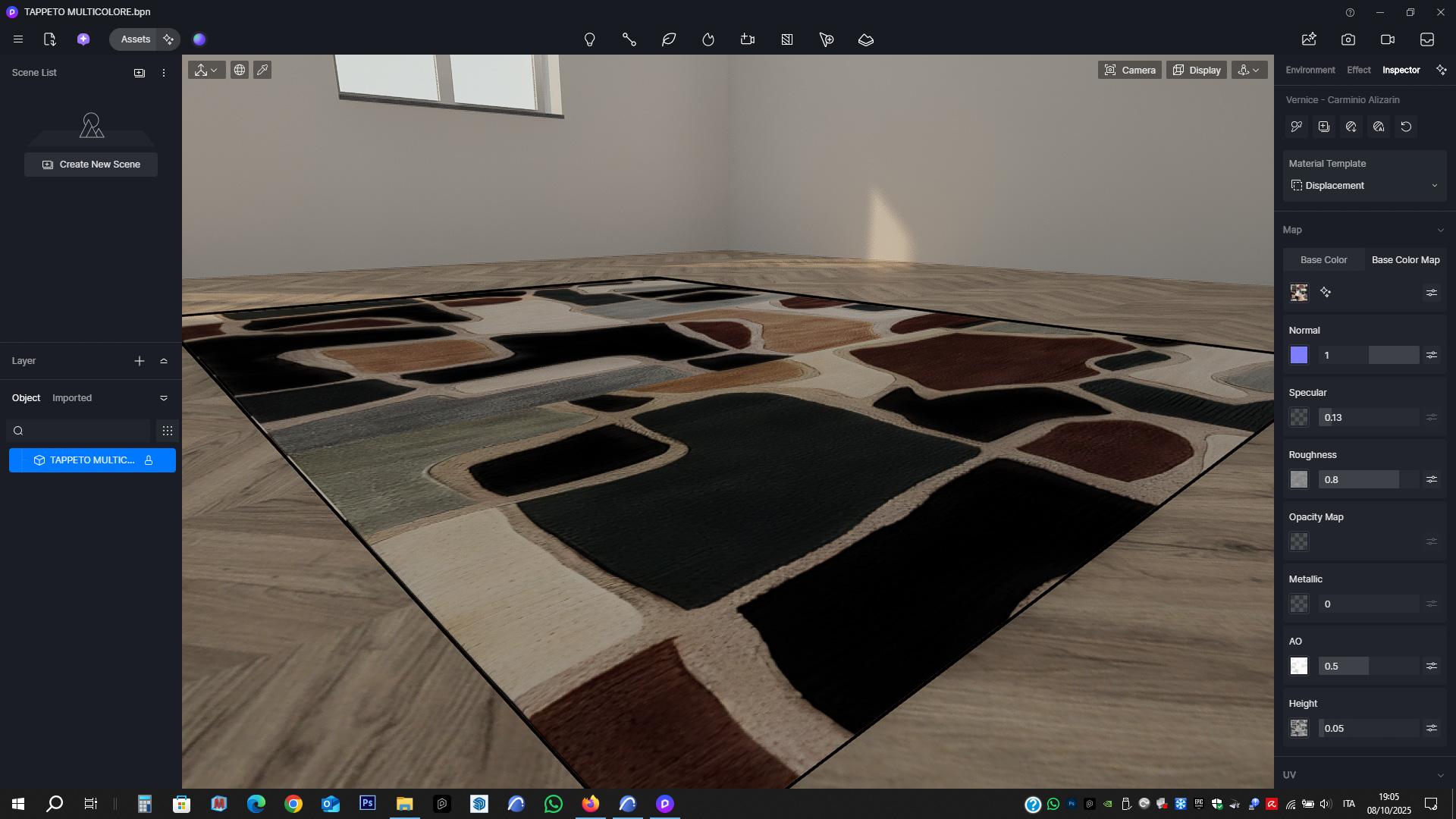

Hi, there would be another faster method. Make the carpet in the Garfica program with the weaving of the image posted by you. In this way you can select it and give it the displacement material, but make the HD Image HD and then make sure you have the other PBR textures with IA. And give him the of values. If you are not satisfied then you have to adopt the method that Anthony_05 suggested you.
This result
this is done with AI
