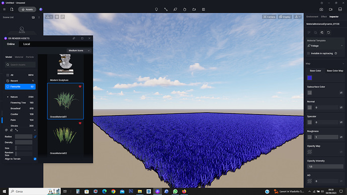

When I take the grass, a dropper doesn’t appear like you mentioned, so I can’t change the color.
It should appear automatically in the right bar, right? where are the layers, symmetry, focus…?
you have to click on the dropper on your left at the top where it moves and scales the object.
then go to the grass texture, click on it with the dropper and the curtain with the material with the color and mapping will come out on the right
here I selected the grass that I modified, you can see it on the dropdown
here I take the dropper on the left and I’m going to select it
on the right the material of the grass I inserted will come out, notice the logo at the top and leaf the material
here I can change the color
then I go to the material map and change the color shades a little
you will see the change in color even if there is a map that I have inserted. Blue has no effect
Good job, I hope I was clear in this case :slightly_smiling_face:
Hi i have a question. How do you manage to get a different colour of the grass?
Thank you in advece?
Hi, just look at the pictures above and look at the settings on your right, then you can put any color
