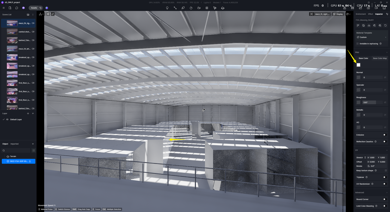

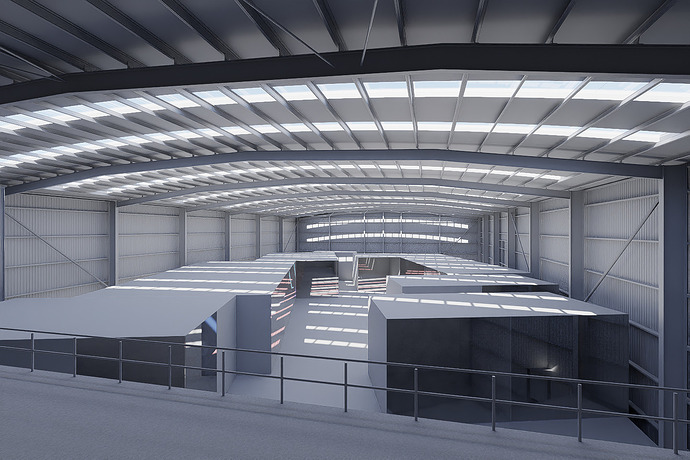

Hello the glass appears to producing pink rays in the rendered image, when the preview doesnt have any sort of rays appearing inside the glass
1st let me show the preview image

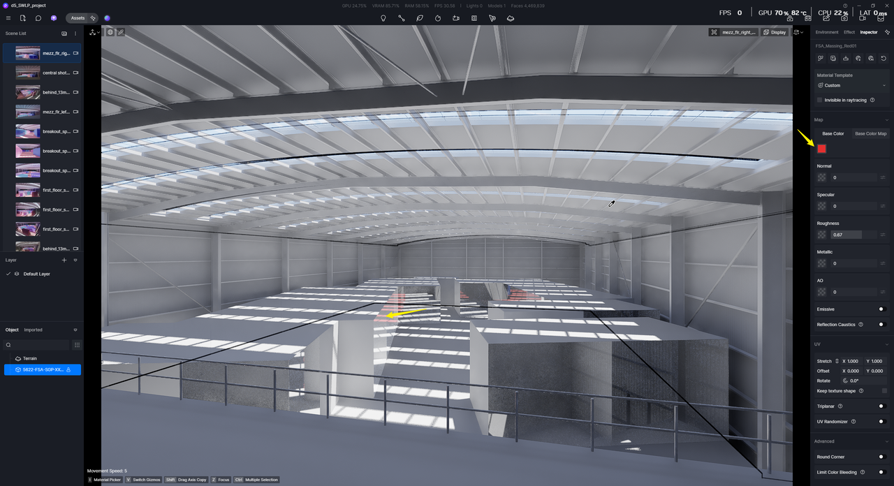

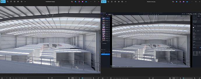

then see what happens if hit render

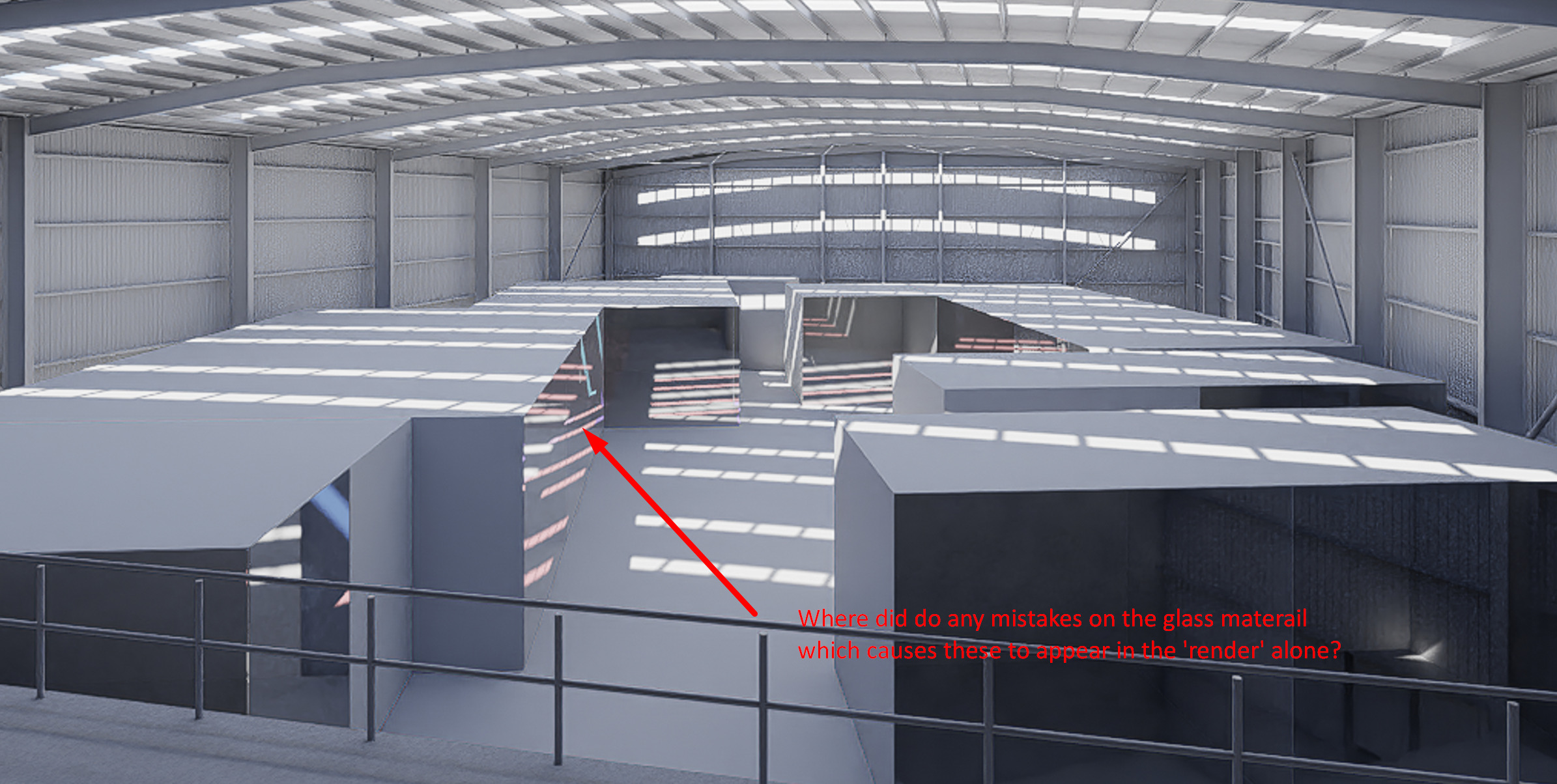

please let me know what do you think of this issue in the clay renders

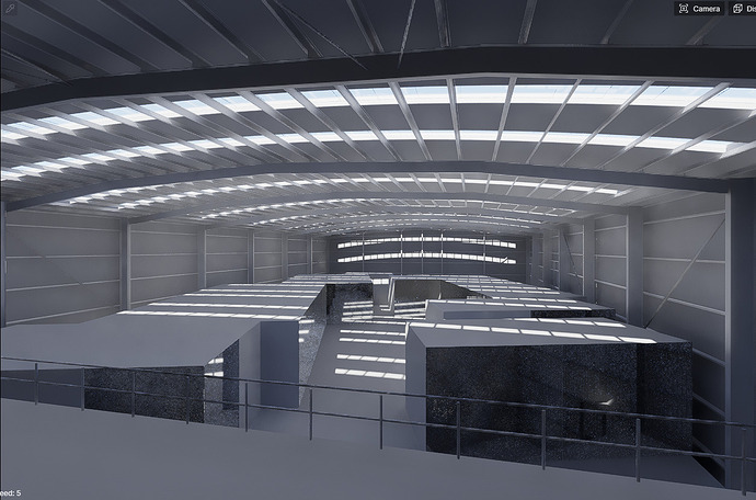

In general renders no such problems such as these
find the below image where nothing like the pink internal reflections happening
If anyone could help on these , please share ur views and thoughts
the glass material adjustments needed something i guess, direct me what to have to not have any sort of pink reflections in the clay renders

This is how it looks like on my end.
I may need to confirm if this is under expectation or a bug/limitation. I’ll get back to you as soon as possible.
This is currently a known-issue which will be further optimize in subsequent release.
