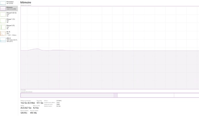

Hi, thanks for sending this information.
- Could you also send your system info?
- Does the crash only occur in a specific file?
- Were these information (VRAM and Memory) opened together with the D5 File where the issue was evident?
this VRAM and memory information was opened before the machine crashed. I also tried rendering in HD and had no problems, but when I tried rendering in 4k the machine crashed.

It is the screenshot of the video memory usage when the video rendering starts.
