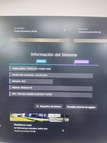

Also, it´s attached some images about the performance of RAM, and GPU.

The image you provided also shows that your Memory speed is 4,400 MHz, and anything higher than 4000 MHz can usually cause crashes and such. You could go to BIOS and turn off XMP to change the memory speed or try to update the BIOS version. You can refer to this video https://www.youtube.com/watch?v=h-MLhGMtheM
