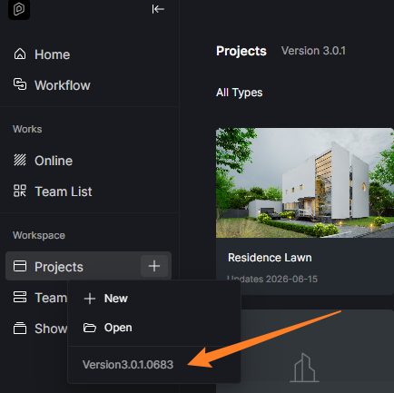

**D5 Render Version:3.0.1
**Graphics Card:Nvidia Quadro RTX 6000
Driver Version:
**Issue Description: D5 account Keeps on logging out

- D5 Render Version
