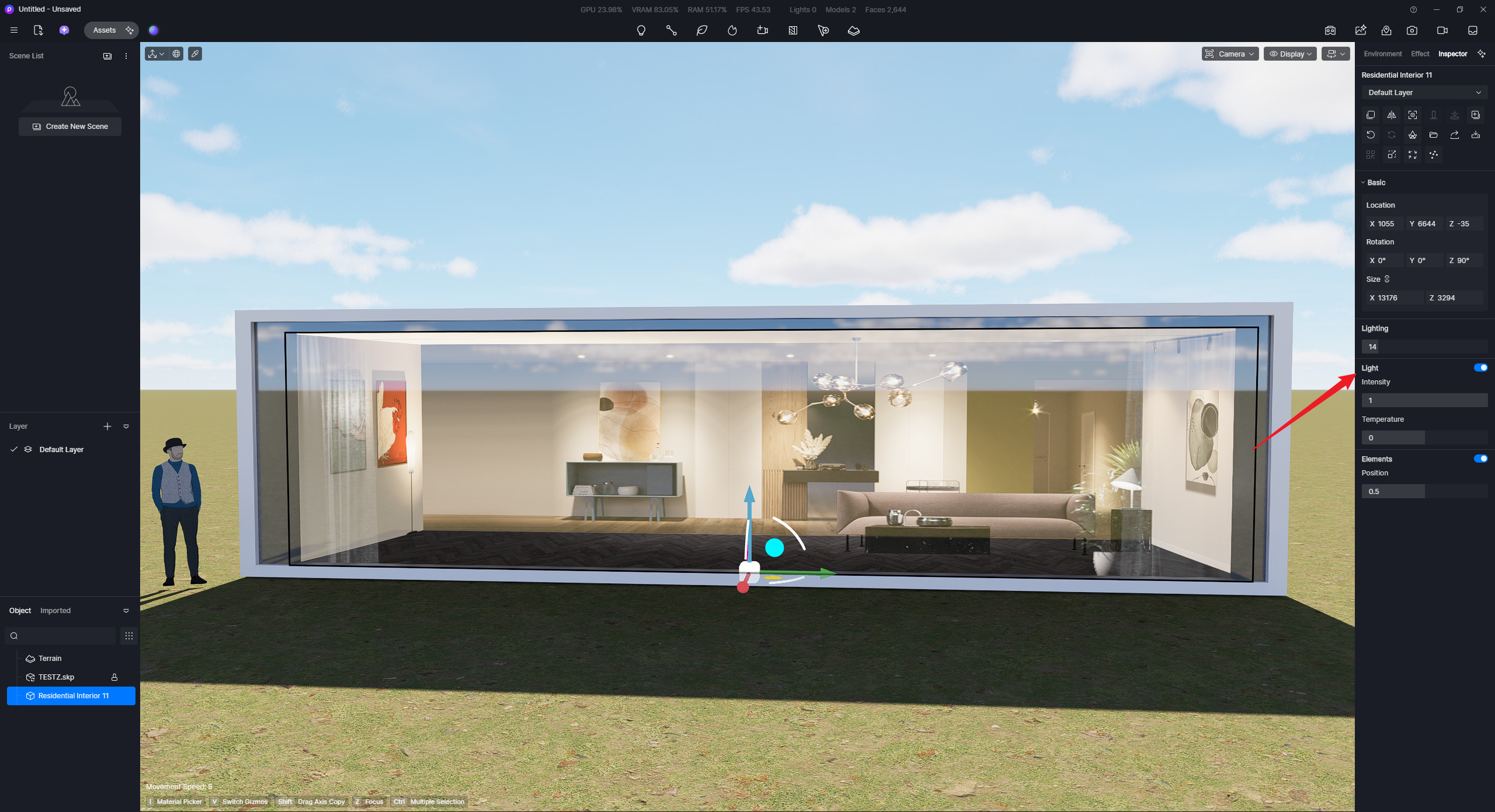

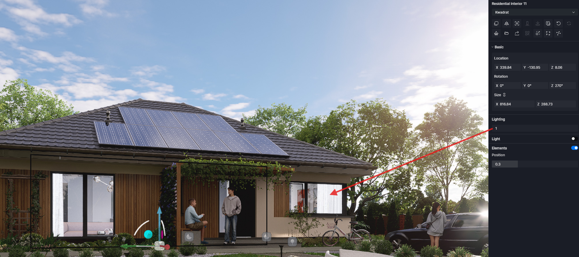

Interiors Parallax interiors completely over-exposured using low Sun intensity
Interiors completely over-exposured using low Sun intensity and higher Exposure values

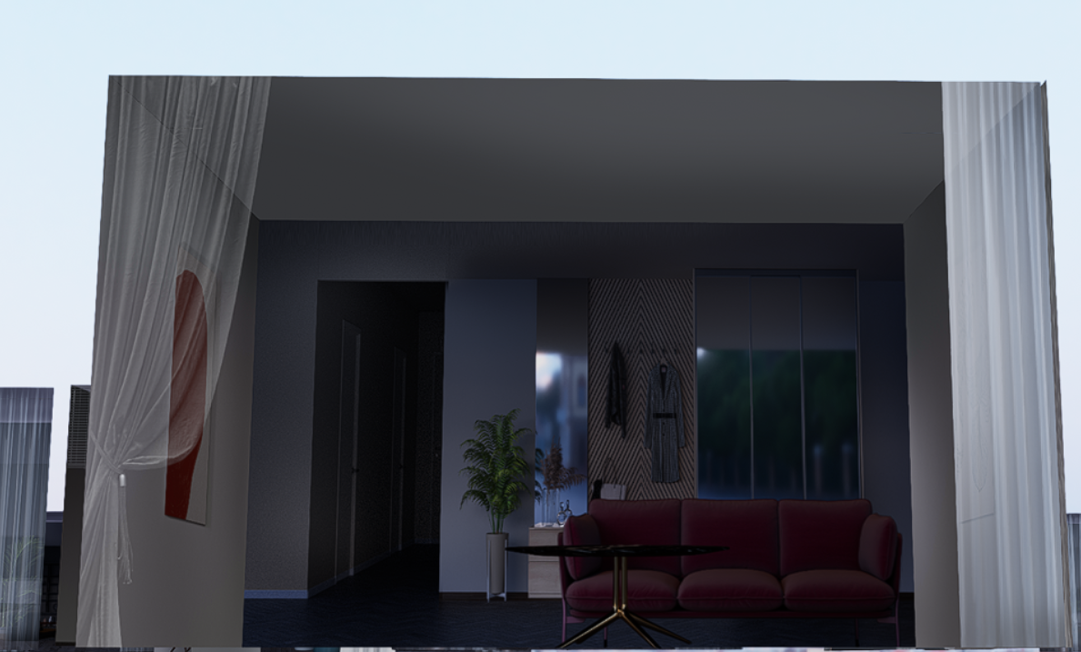

because they works like emissive objects not diffuse ones.
This is related especially to curtains and bright soffit on some interiors. They are overexposured.
Some interiors have good looking curtains, some other overexposed.

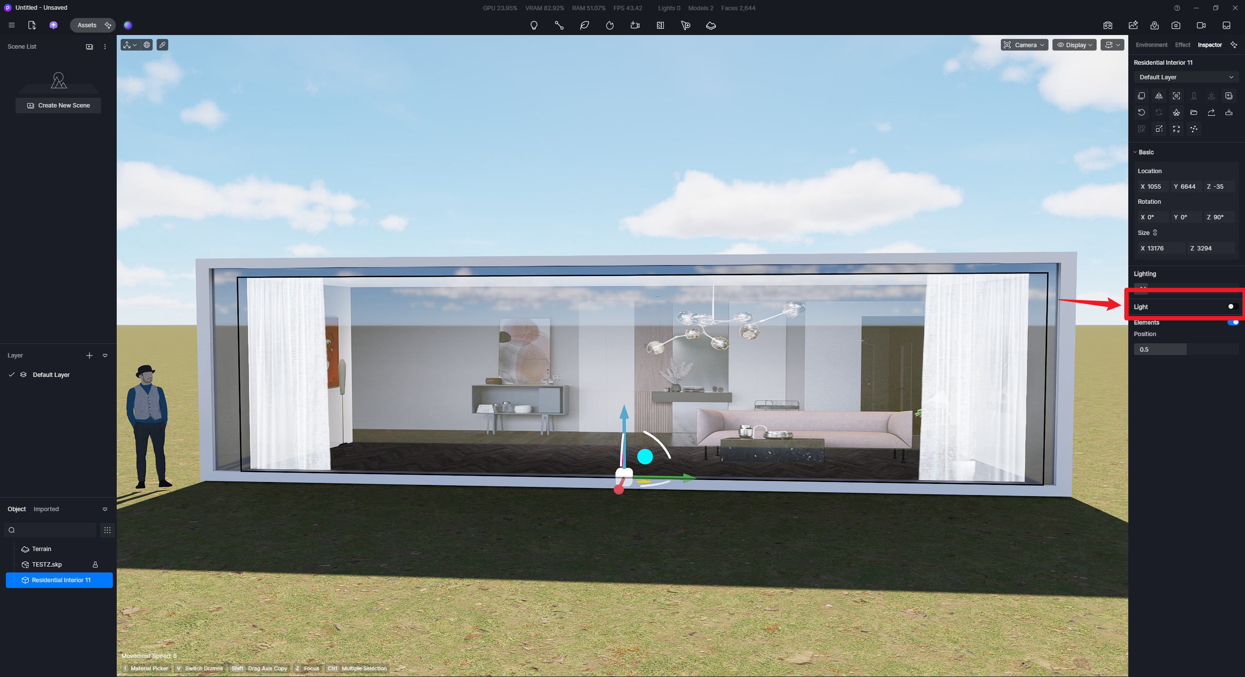

I’ve run some tests with Interior Parallax and found that this is not due to using Low Sun Intensity or to higher exposure values. When “Light” is disabled, the curtains will appear to have a more solid color.
Anyway, we’ll consider this as feedback and will make adjustments. Thank you.

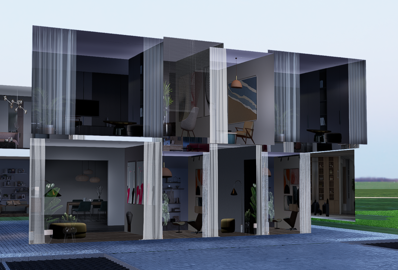

The problem is that interior parallax works as light emiter, like emission material not diffused one. That cause when we have low light scene or shadows area these interiors looks way too bright compared to interiors on sunny side.
In other software interior parallax works like 75% diffuse material and 25% like emission material. This is good relation, compromise to have interiors interact with scene lighting and not to have them fully dark.
This is how interiors looks on sunny side and shadow side. Another not fully tested “feature” for professional usage.

Also many interiors have different curtains brightness so they looks strange on low-light condition. Every interior needs different brightness settings :

I noticed that this effect is also caused by auto-exposure. On sunny side autoexposure lower exposure and interiors are additionally more darkened.
Please observe curtain brightness while sun angle is changed :
curtain_angle_sun (2).zip (3.7 MB)
Completely inverted compared to reality. Because all other scene materials react to lighting and auto exposure. Interiors stays the same because they are emissive with zero diffussion.

The worst thing is that interior parallax brightness highly depend on exposure level but completely ignore light strength.
If you have dark evening scene with proper set interiors brightness they are completely dark and invisible in strong light daylight scenes when exposure level is much lower.
Because lower exposure make them darker and current light strength doesn’t make them brighter like all other scene elements.
