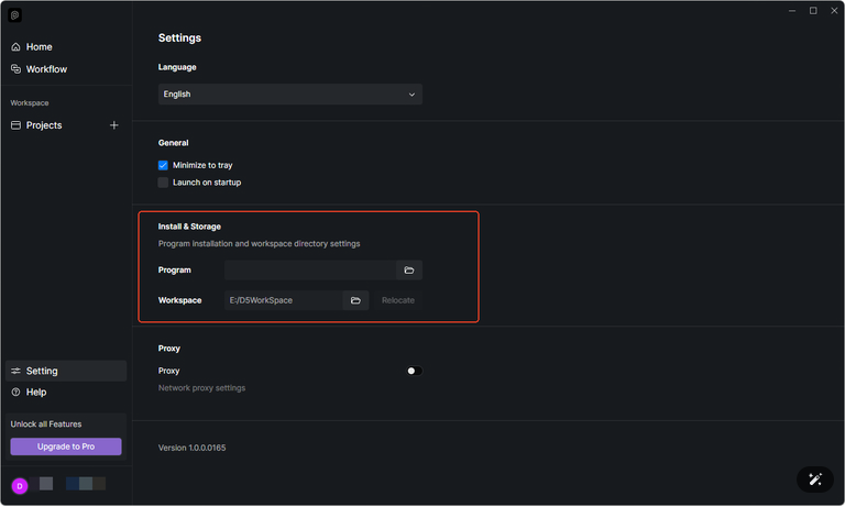

Are you referring to the Inadequate Permissions? If so, this has long been addressed.

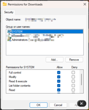

You can open the current workspace location to check whether you have permission to create new documents in this path; if you don’t have the relevant permission, you can run D5 as an administrator or
Ensure that you have full folder control
