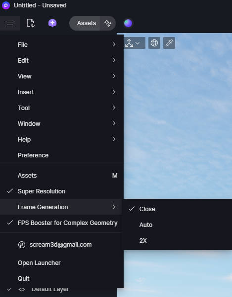

(with Attached Screenshot of My Settings)
set 02

  • I was also able to check the video you have rendered, and regarding the flickering issue, you might want to try to disable Super Resolution temporarily and see if the flickering persists.
  • In the event of we are unable to replicate the flickering issue on our end, perhaps the issue is specific to your device, I would recommend upgrading your GPU Drivers, or revert back to a more stable version of NVIDIA Drivers.
I have tried disabling Super Resolution, but the severe flickering issue still persists. This problem has existed since version 2.7 and continues to this day, so I believe it deserves serious attention from the development team.
I have already updated my GPU drivers. Perhaps you could try rendering my scene into a 4K night animation sequence and compare it with the night 01.zip (the sequence I rendered myself). This way, you can check whether the output quality is just as poor.
