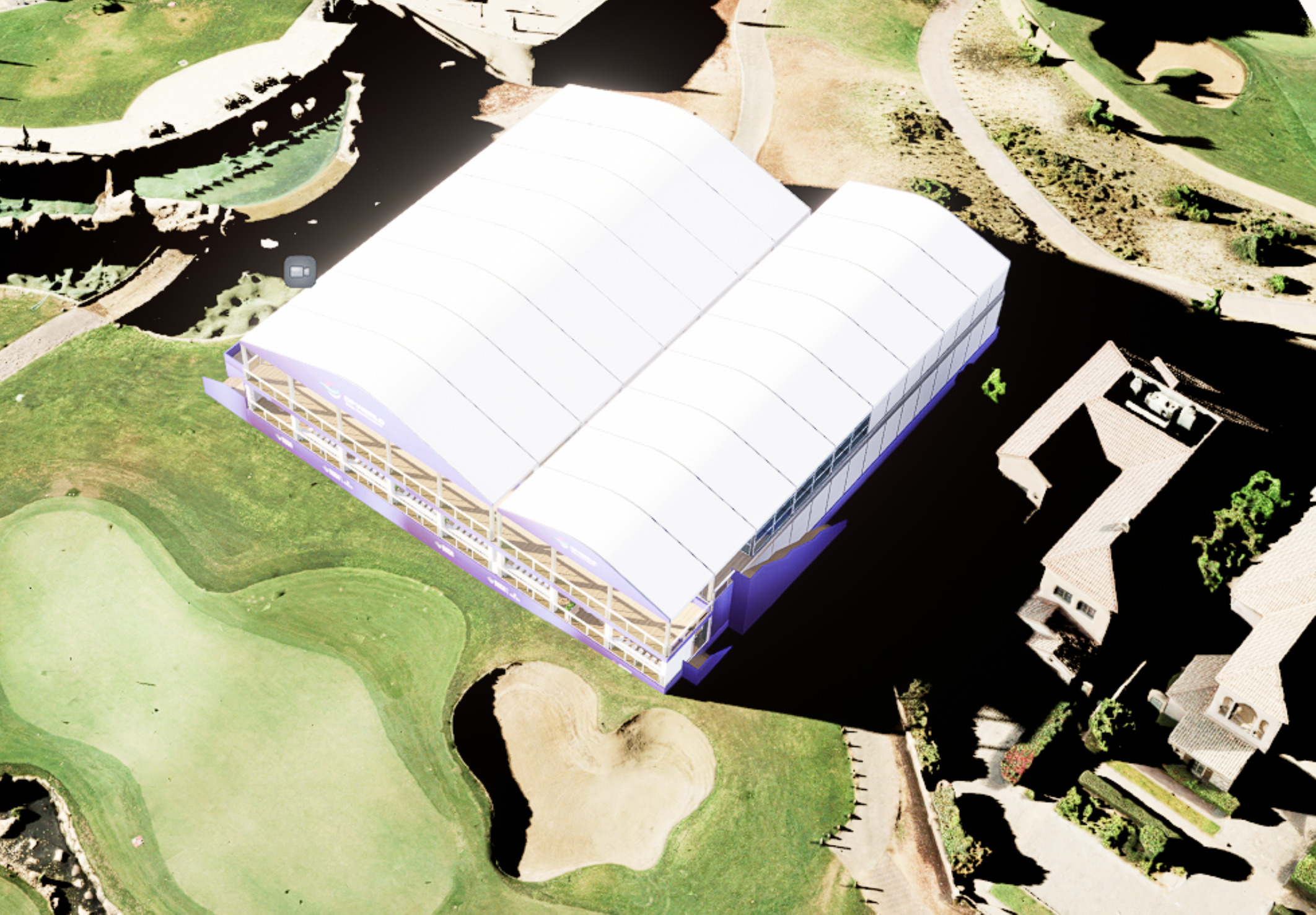

  • When “Round Corner” is enabled, it will result in a Darker Scene or a portion of the surface.
    Credits to Pedro Rivera for this Image Test

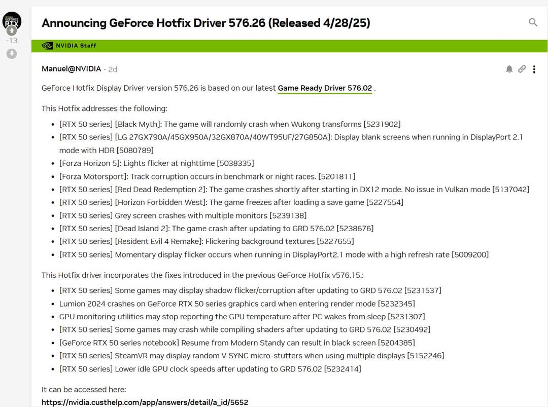

  • Update to the Newer Version: 576.15 - Although some users have reported that this has not solved the “Round Corner” Issue (experienced by 5000 Series), but has improved the overall performance of the lower series. It is best to kindly wait for NVIDIA’s Update.

thank you for testing and letting us know that the new 576.26 driver is also not good.
