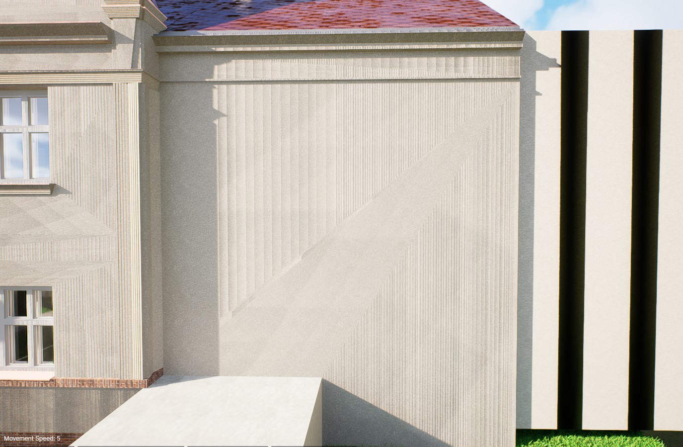

Hello,
I have a problem with texture.
There are shadow stripes and strange glitches in several textures.
I thought its too far from origin point, but the problem still remains after moving the object close to origin point.
Hello,
I have the same problem.
It is caused by some new drivers from Nvidia. You need to remove the option “rounded corner” or revert back to an old driver.
More info here : [Hot Issue] RTX 5000 Series with NVIDIA Driver 576.02
I´ve thougth its too far from origin - the model is from archicad and i was searching for an object with very distant origin - but there was no object like this. Problem was caused by curved wall. The diametr of the wall was so large, that the centre point of the radius was far a way from origin point.
Hi @vilem.kocab
Thanks for the update. Just to clarify, this issue’s root cause was in the 3d Model’s round corner and not in D5’s setting, right?
The problem is from the latest Nvidia drivers for some graphics cards. A temporary fix is to uncheck the rounded corner option in the texture of D5.
Nothing to do in Archicad.
I would like to add a comment for Archicad users who might encounter the same issue. The problem of incorrect surface rendering in Archicad occurs because something is located very far from the project origin. However, it’s not only about the actual Archicad objects in the project. In one case, it was a curved wall with a large radius—the center of the arc was several kilometers away from the origin. In another case (see attached image), Xrefs in a worksheet were positioned far from the origin. It wasn’t an element in the building stories, but
an element in the reference worksheets… (the Xrefs were placed according to the real-world coordinates provided by the surveyor).
