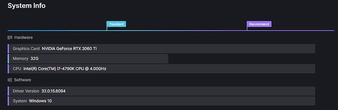

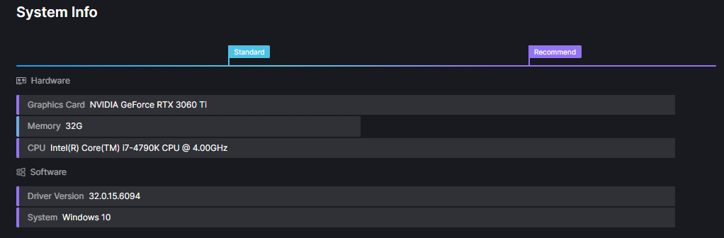

I tried the following drivers:
552.44
591.74
581.57
560.94 (current)
I’ve noticed that this often happens when I zoom in on a detail (for example, when tweaking a texture) and then zoom out using the mouse wheel; the program freezes and crashes without displaying an error message.
In the BIOS of my motherboard (MSI Z97-G43), the option to disable Turbo Boost isn’t enabled, but it seems I’ve effectively disabled it via the MSI Intel Extreme Tuning Utility.
It didn’t help; the program still crashes.
The program crashes on my second computer as well (i5-14400F, 64GB, RTX 4070 12GB, Win10).
Since the release of versions 3.0/3.01, working in D5 Render has become completely unusable.
True Displacement is highly performance-intensive, and Remesh does not work properly.
Reloading edited SketchUp models (directly from the file) into a project often results in errors in the model (scattered gray parts of the model).
D5 Render is becoming completely unusable for serious professional work.
Features have taken precedence over stability, but without stability, features are useless to us.
D5 Team, wake up please.
