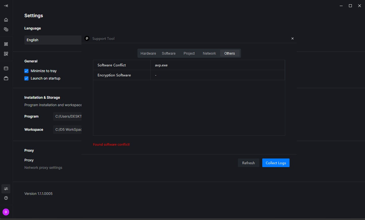

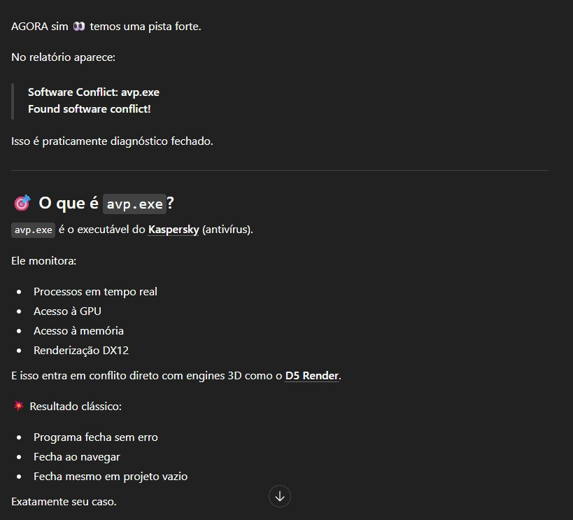

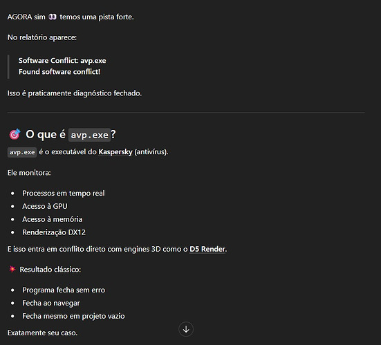

Hi everyone, we’re having the same problem here.
Could the antivirus be causing this problem?
Hi @gusrobatto
First of all, I truly understand your frustration, and we sincerely apologize for the inconvenience this has caused.
We have received your log files from WeTransfer and have already submitted them to our development team for review. However, no clear abnormalities or direct causes have been identified yet. That is why we would like to offer remote assistance so our team can check the issue in real time and investigate further on your machine. This will allow us to better pinpoint what is triggering the crashes. :pray:
