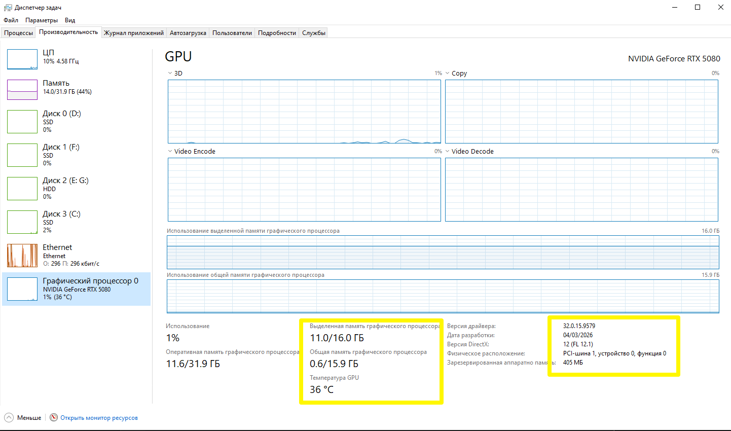

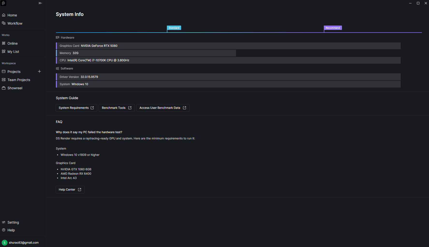

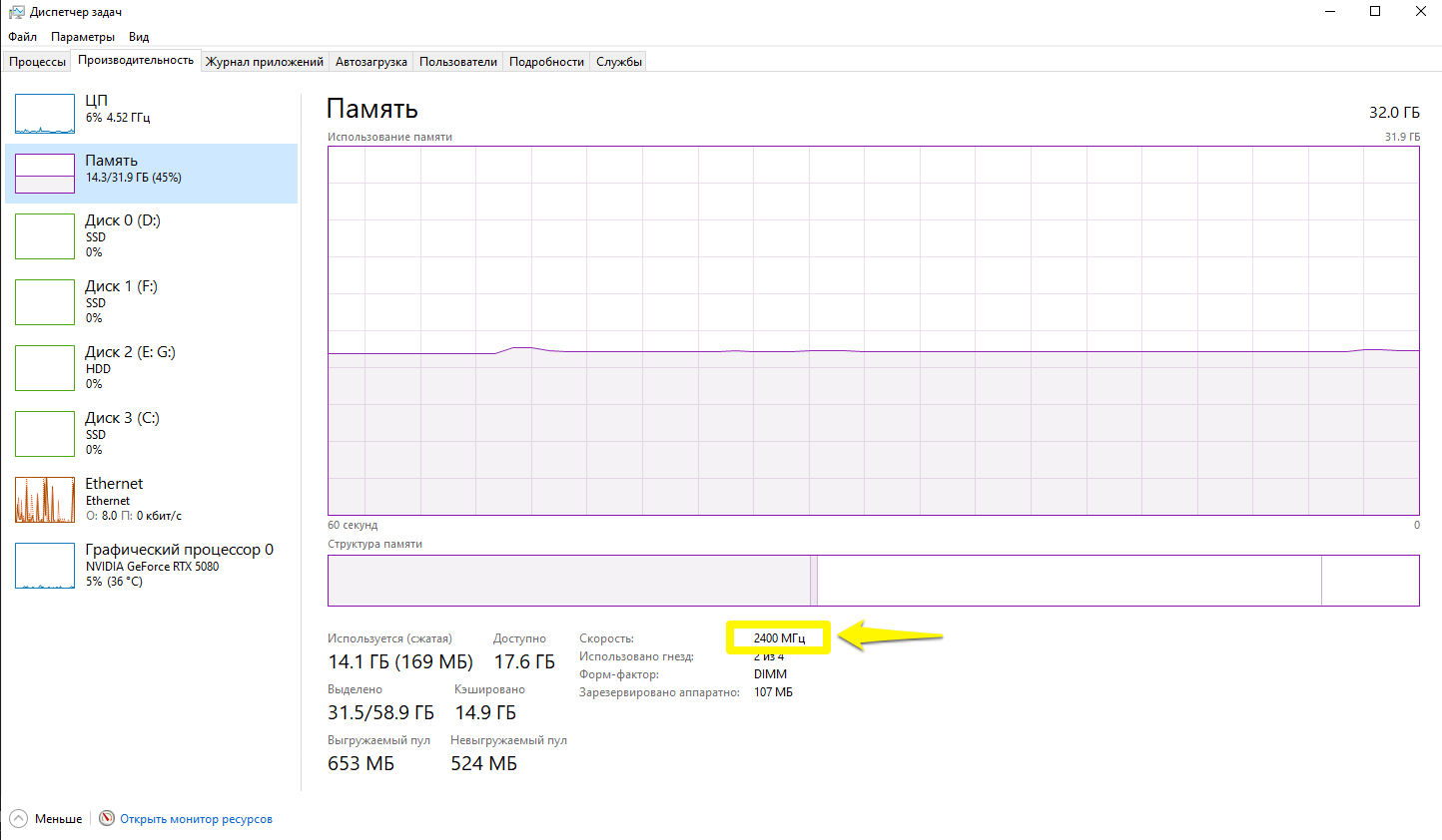

Is there any news regarding this problem? I have the same thing - the program just crashes without any error or warning.
Hi @shurao83
Could you please provide more context regarding the issue you’re experiencing? If a file crashes due to excessive VRAM usage, it often indicates that the file is too large for your VRAM to handle. This is an expected limitation, and the only solution is to optimize your file.
  • This issue appears to be specific to files that crash after the 3.0 or 3.0.1 update. If you can confirm that using version 2.11 or any earlier version does not cause your file to crash, then we may need to gather your log files and scene files for further investigation.
  • Several users have confirmed that disabling Turbo Mode in their BIOS helped.
Additionally, if your file crashes even in previous versions and have exceeded VRAM, you may create another forum thread along with this information:
Can you please confirm if this issue occurs to a:
  • Specific file
  • Or it is also evident to all of your other D5 Files
We may also need you to send the following images/information:
I tried opening other files, and the result was the same: the program crashes a minute or two after opening, without any warning or error. I’ve never had this happen before. I don’t know if this is related to the version update, but this definitely didn’t happen with previous versions.
