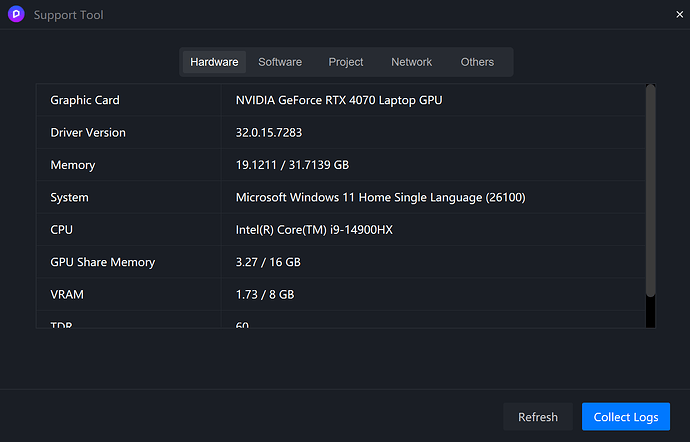

Additionally, Can you try these two:
If the issue persists after doing these two actions, you may send your D5 Render File and Log file to support@d5techs.com and have it titled “Clov-Forum HELP! D5 2.10 keeps crashing a lot!!
