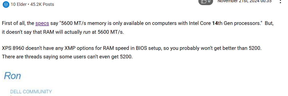

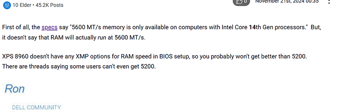

Please note that the XPS 8960 does not offer an option to adjust RAM speeds. I have attached a photo for reference.
Thanks
