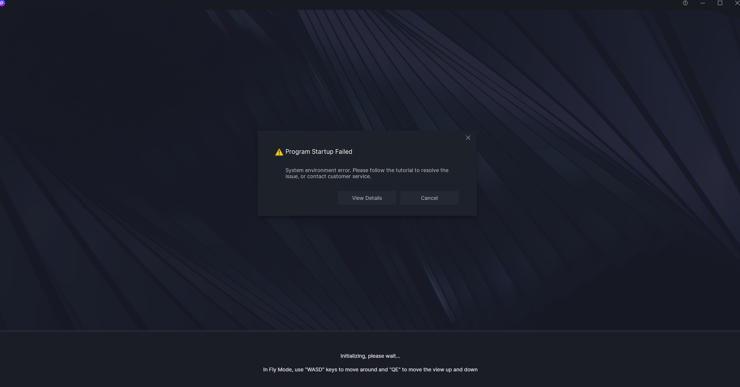

D5 wont start please help.
D5 Render Version:
mvidia rtx 4080:
latest studio:

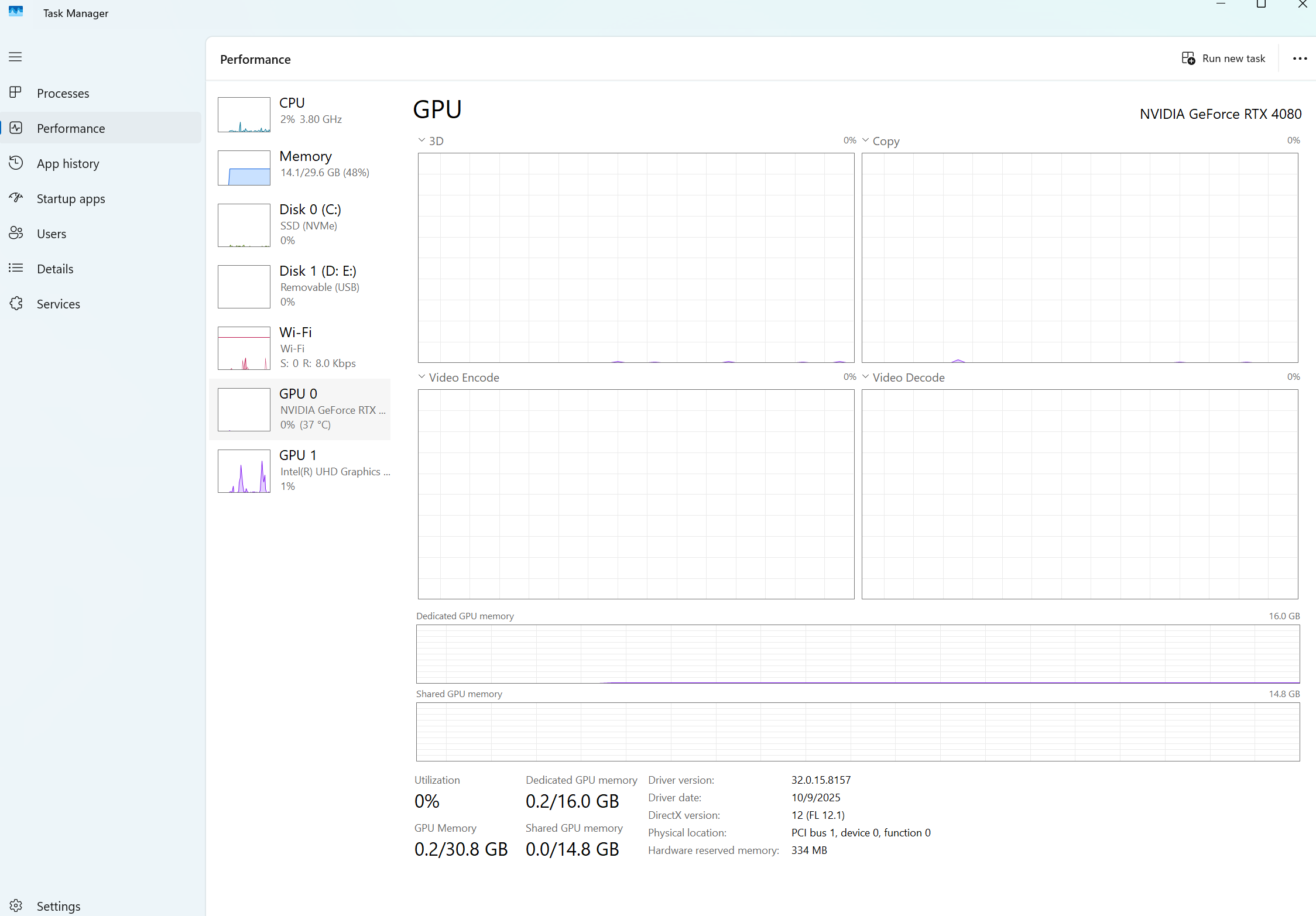

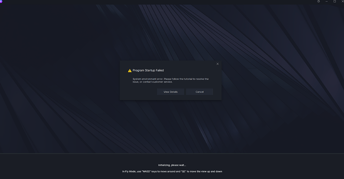

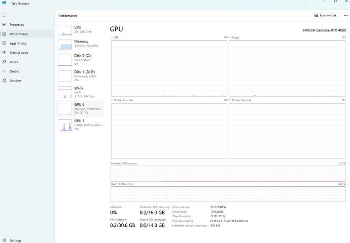

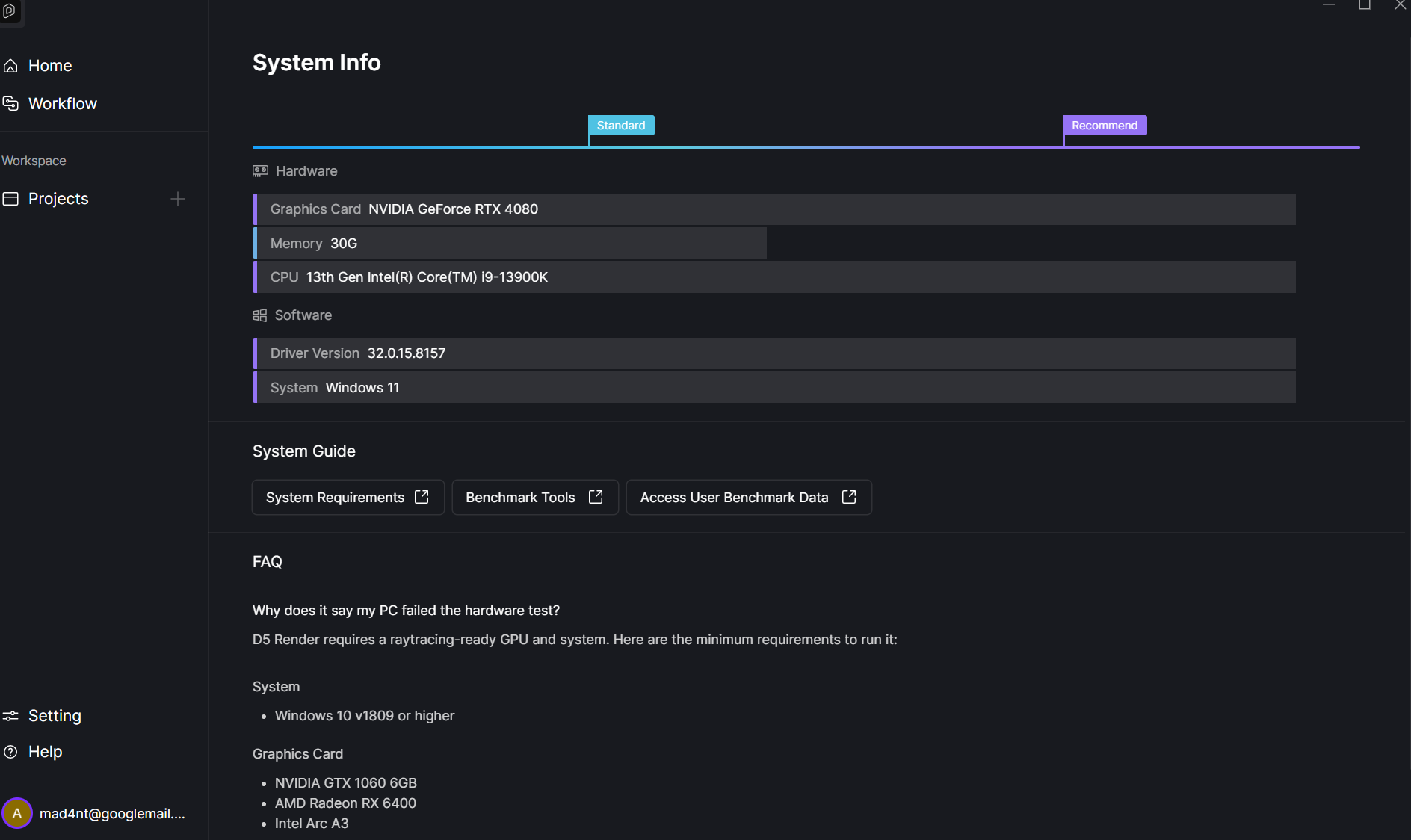

d5 won’t start, please see screenshots.
i also have tried all forum and help centre recommended solutions, nothing seems to work

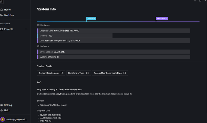

Thank you for attaching your hardware information. I see that you’re using an Intel Core i9-13900K processor.
The Program Startup Failed error pop up is a known issue for Intel Core i9-13900K/KF/KS and i9-14900K/KF/KS CPUs when running D5 or other DX12 applications. This is often caused by environmental/system settings rather than a D5 bug. To resolve the issue, we recommend the following:

I am aware that the Core i9-13900K/KF/KS and i9-14900K/KF/KS processors are known to have this issue. A Dell technician previously replaced the processor with an upgraded version, along with the RTX 4080 graphics card and a new power supply. The BIOS was also updated during that visit.
Following these changes, D5 functioned perfectly until the release of version 2.11, after which the same issue reappeared.
I contacted Dell and explained the situation. They verified the hardware and confirmed that the new processor is not faulty, as it belongs to the latest batch.

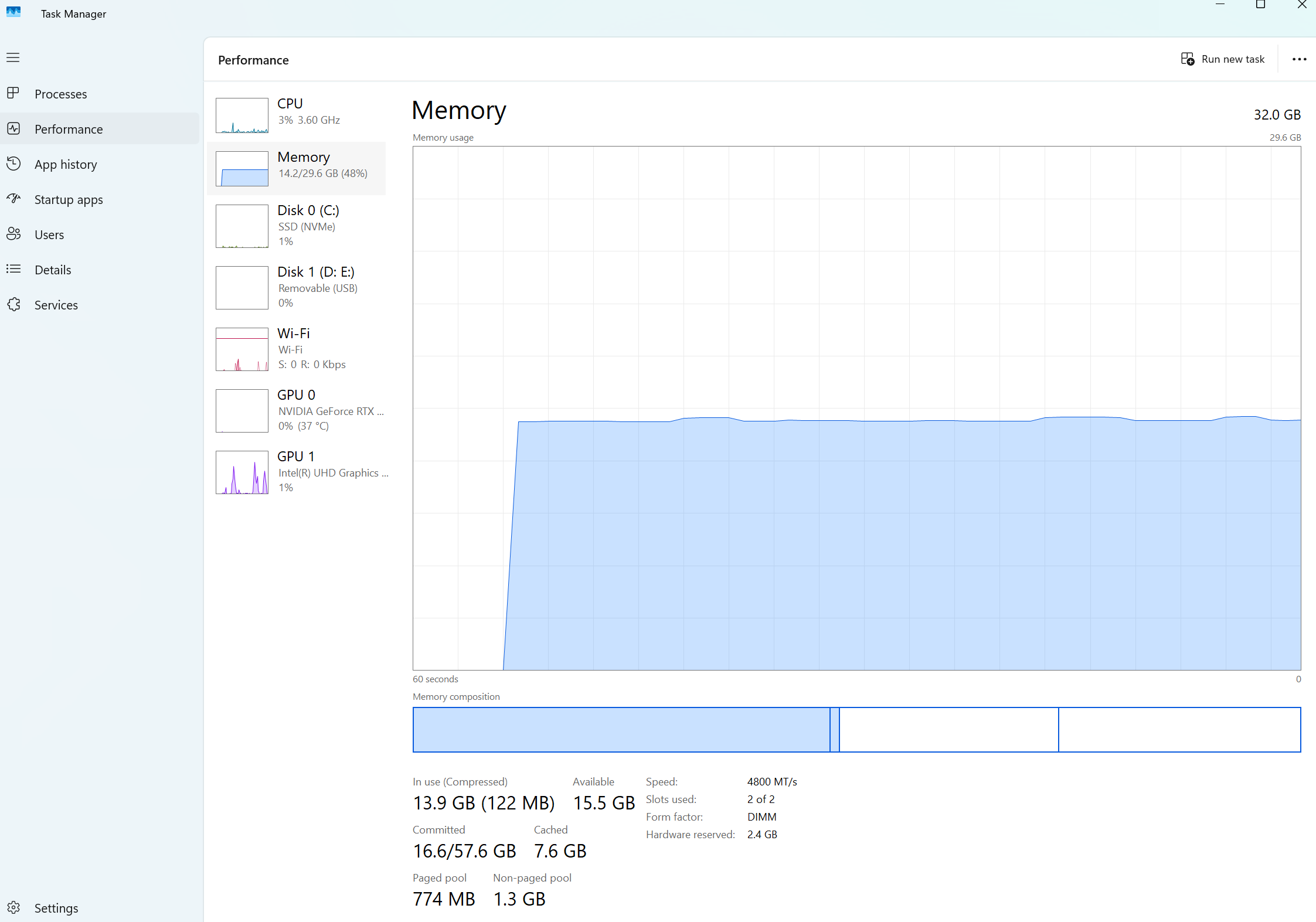

Please note that the XPS 8960 does not offer an option to adjust RAM speeds. I have attached a photo for reference.

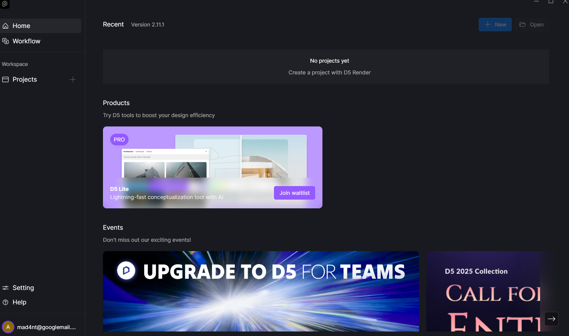

Hi, i tried older versions, and having same issue, also just now downloaded 3.0 version and again same issue.
Also downloaded d5 Lite for sketchup and it works inside sketchup, but as soon as i click sketchup live sync, same issue as mentioned above in photos.
