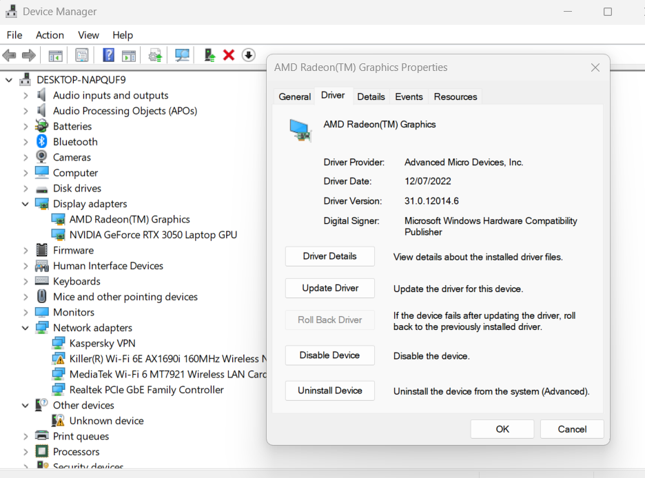

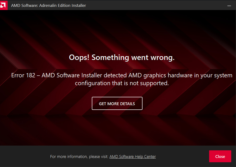

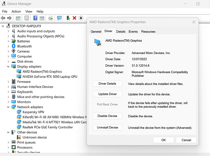

I tried, I have Error 182 - AMD Software Installer detected AMD graphics hardware in your system configuration that is not supported.
Hi @egie_tinga

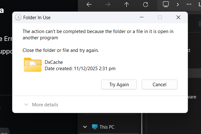

Sorry about that. Did you remove the files from the two directories below before rolling back?
\AppData\Local\AMD\DxcCache
\AppData\Local\AMD\DxCache

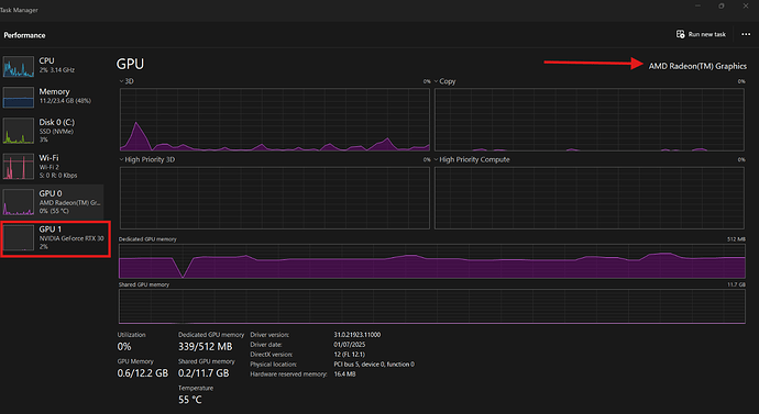

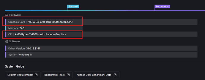

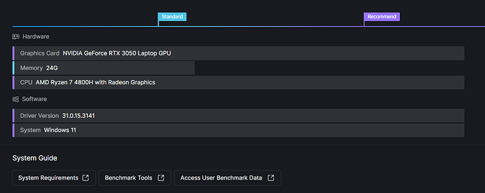

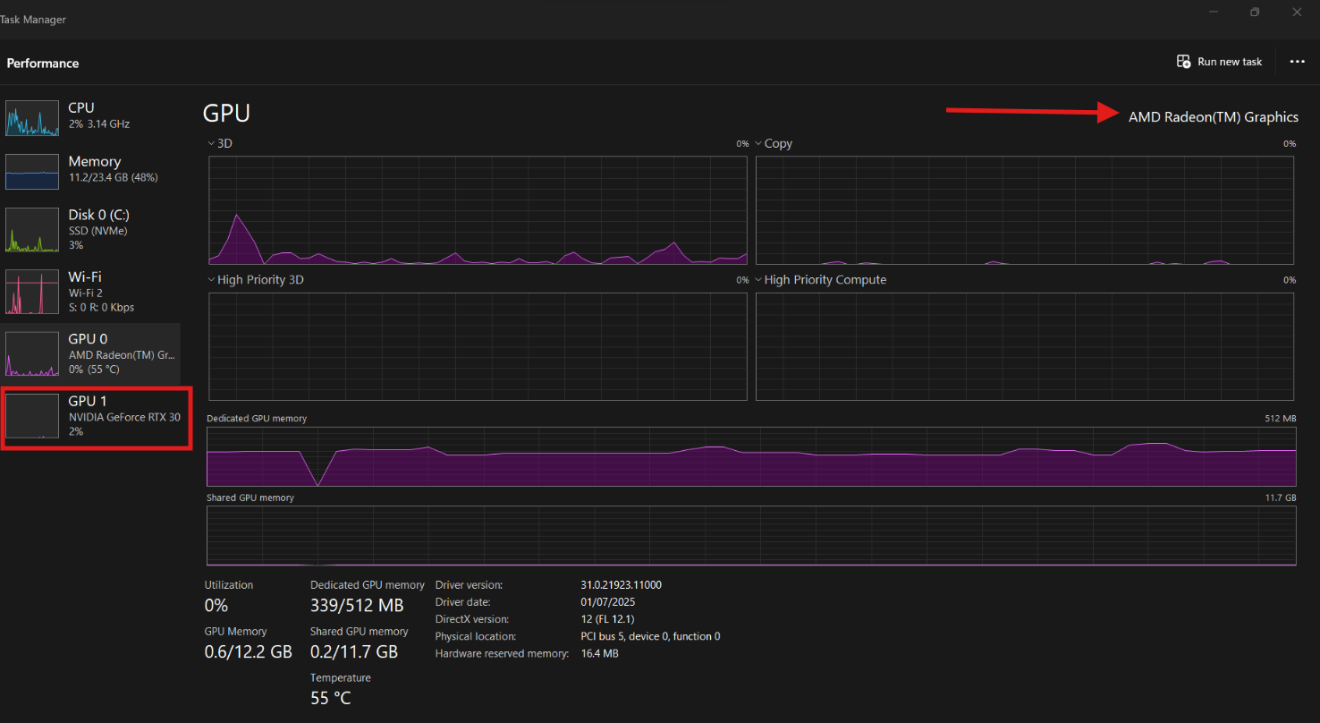

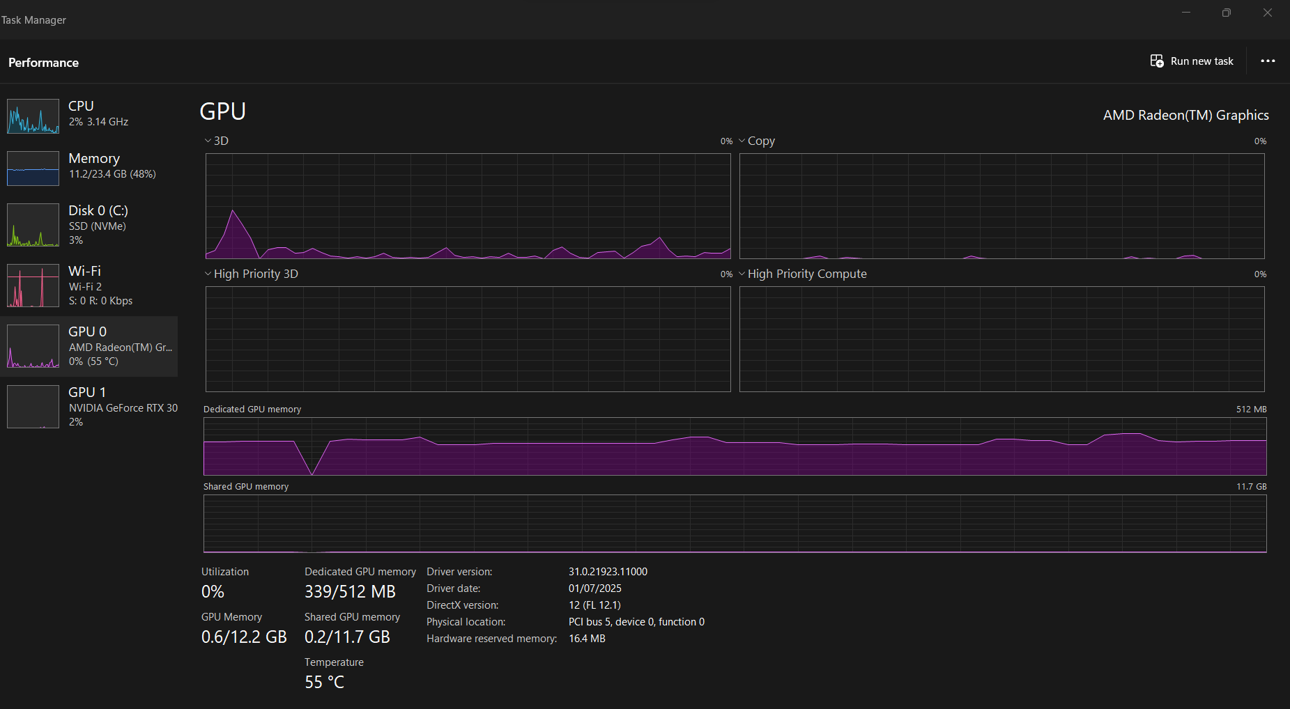

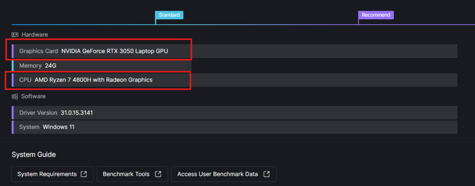

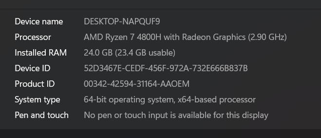

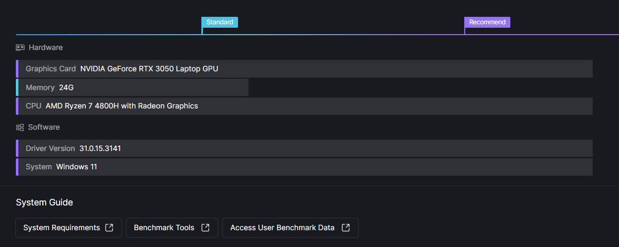

Hi @egie_tinga
Apologies, could you please first send a screenshot of your System Info panel in D5? This will help us confirm which GPU D5 is detecting.

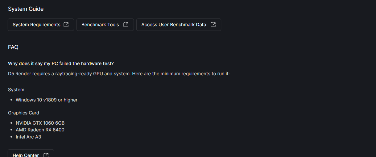

It seems D5 Render cannot run on your processor, integrated Radeon Graphics of the AMD Ryzen 7 4800H processor because the software requires a dedicated graphics card that supports hardware ray tracing. Integrated GPUs are not supported.
Hi @egie_tinga
Thanks for sending the details. It makes sense, the Error 182 you’re seeing means the AMD driver installer detected that your system does not have a supported AMD GPU, so it refuses to install the driver. Since your GPU registered in D5 is NVIDIA, and your CPU is AMD.
This error usually appears when you’re trying to install an AMD graphics driver, but your system does not have an AMD GPU, or the driver package doesn’t match your specific hardware.
