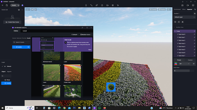

Hi, you make grass with this material and then you use intelligence to change!
Then go to Scatter select the grass you want
I chose the tulips, I go to the grass and click and then create
and I see the result
This is the render
Then I also did the test with glass, which disappeared in your reference, the result is this
Render
Also done with double glazing
Render
And it doesn’t cause any anomalies
The only thing to check is if all the types of grass you have selected are loaded, assuming that you are a subscribed user of D5, because you know that some models load the Free ones while some are not loaded if you are not a PRO
You must check this on the drop-down menu on the right, when you select the Scatter

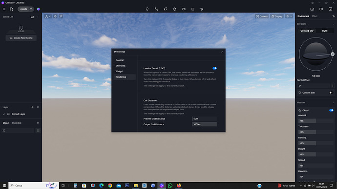

Try increasing in preferences, the distance on this
See what happens
I understand. You’ve been a great help, and I’m very thankful. If you could take a look at my file once, it would be incredibly helpful. I’ve tried various approaches like LOD, cull distance, and rescaling the scene, but the issue persists. I’m not sure what else to try, and it’s affecting the animation quality. I have a deadline to submit the work on Thursday.
Ha, I’m sorry about this, but are you sure it doesn’t work, I showed you how to do it you have to increase the distance, if the area to be mirrored can’t be seen you have to bring it from 50 to 1000 and below from 1000 to 5000, look, there are a lot of people, let’s talk of metres
