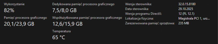

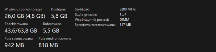

Hello, I’m having a serious issue with D5 Render crashing during video rendering (both mp4 and sequence). The render fails even at 720p. The scene is large and definitely demanding in terms of RAM and VRAM (both are used at around 90%). I’m attaching the specifications of my computer and the d5_immerse log (should I include any other logs?).
I’ve already tried running the program as administrator and modifying TDR values in the registry, but it didn’t help. There are many variables that could be causing the crash, and sometimes the render does succeed. However, if the camera is closer to elements like grass, or if wind effects are enabled, the program crashes during rendering. I’m unable to identify what exactly is causing the issue.

Here’s the information you asked for. As I mentioned earlier, both RAM and VRAM are heavily loaded, and this issue doesn’t occur in an empty project. However, I still think this shouldn’t cause a crash, maybe just a longer rendering time. What should I do next? I’ve already gone through everything from the guide you sent me, and nothing has worked.
I have the impression that over time I’ve been able to render at lower and lower resolutions, even though I haven’t added anything to the project. At first it crashed at 4K, then at 2K, then at Full HD, and now I’m having issues even at 720p. I deleted the f2 folder, but that didn’t help either. I have enough free disk space. I tested both the Game Ready and Studio drivers from Nvidia, and there’s no difference.
It seems that rendering distant views or wide shots works, but when the camera is close to grass or trees, the render crashes. I think it would be really helpful if there were a guide about scene optimization: the number of lights, objects, world size, texture memory usage, and so on.
