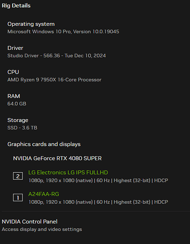

Did you update your assets after opening it? Can you also try to revert your GPU Driver to 6636 or anything before 7216, since we were notified that 7216 is quite unstable and the fix will be released sooner.
Indeed, 720mb is not considered a heavy file for it to be causing a crash also considering you are using a 4080 GPU. Can you send us your project files? So we can also test it on our end. Please send it to support@d5techs.com and have it titled “Clov Forum - D5 Render Crashes at 5%”

I have downgraded GPU to 6636., see below image
