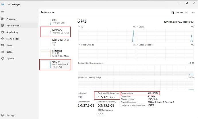

Hi there. I apologize for the inconvenience this issue has caused. Does this issue persist in other files? Or is it specific to this file only? Can you also provide the following information?
