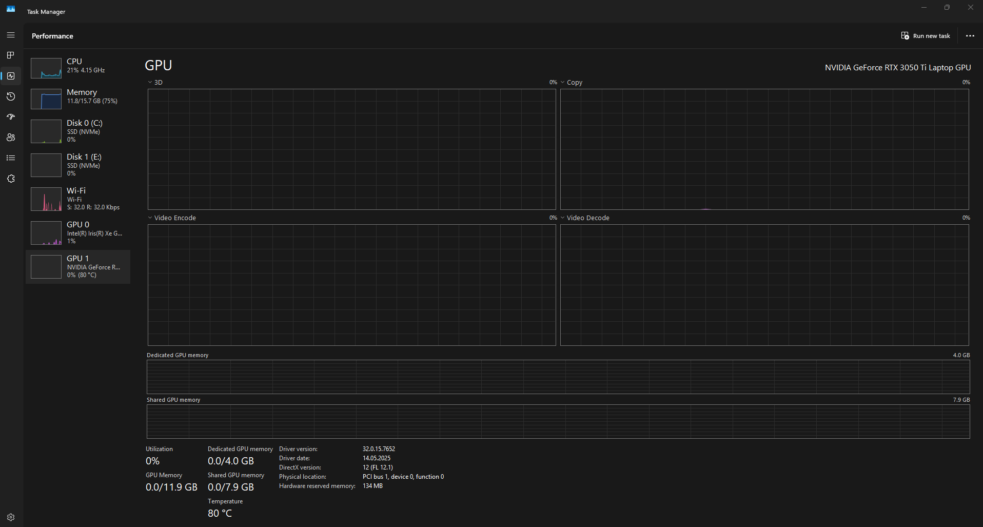

That’s abnormal considering that this file is almost empty. Can you also send the following images:
Although it’s just a guess, perhaps your device is utilizing your iGPU instead of your dedicated GPU? (only for devices who has both integrated and dedicated GPUs)

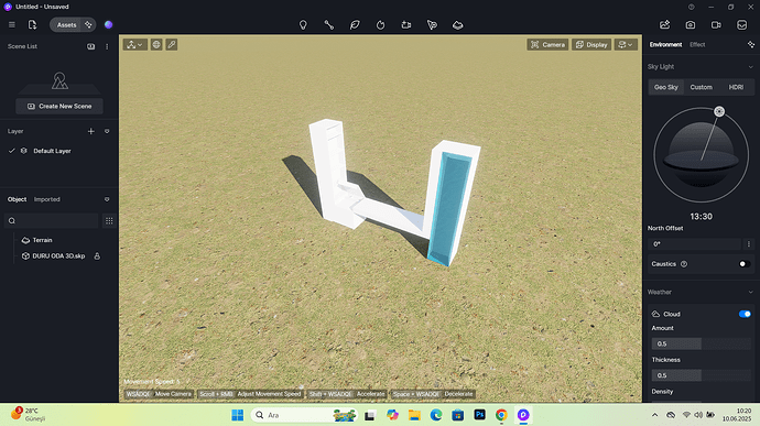

To test, you can try opening an empty file and see if it freezes or use Residence Lawn - Demo File
If the file is quite heavy, then it might be expected considering the 4GB Dedicated GPU Memory that you currently have. ![]()

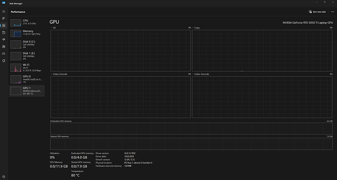

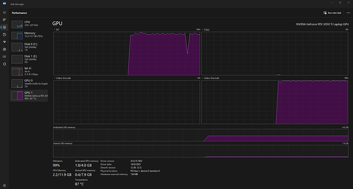

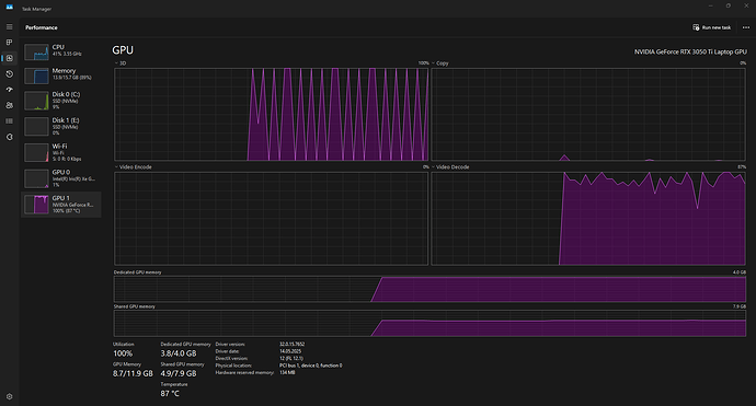

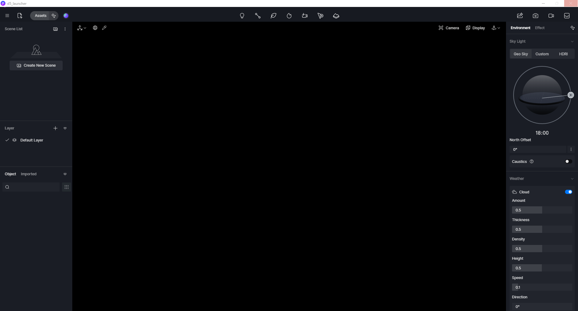

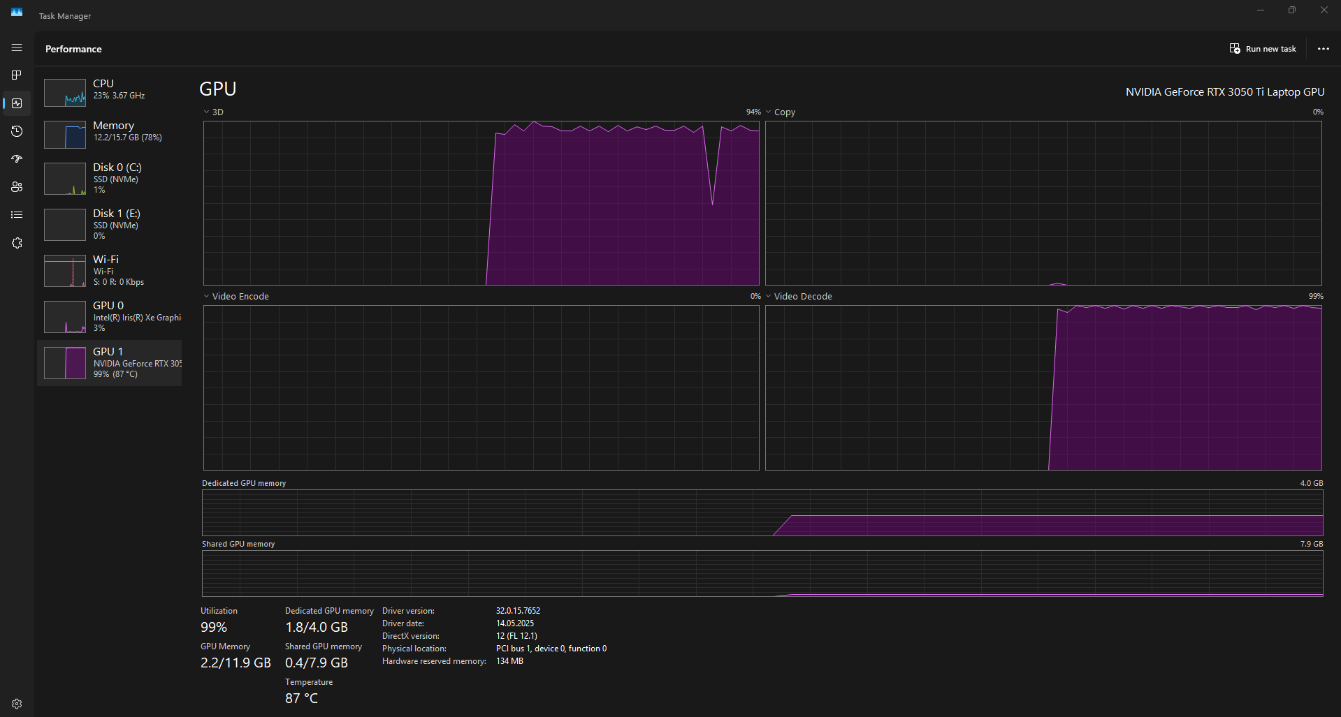

My computer came from maintenance, when I open a new project in d5 2.10 version, after a few minutes the program crashes, it uses 1.8GB as vram, but I saw that my video card uses 100%, I don’t know how it happens, I can’t close the program and I have to shut down the computer, which damages my computer.
Hi @l2011009074
Just to clarify, after your computer was sent to maintenance it perform worse compared to before?
Considering that it is crashing despite opening a small file which is consuming 1.8gb of your VRAM then we might need to investigate this issue further.

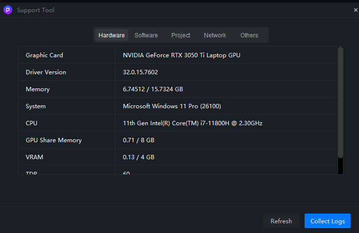

Please send again the following information to support@d5techs.com and have it titled ‘Clov-Forum D5 Ihave a freezing problem’
System Info
VRAM
Memory Speed
New Log Files - How to use Support Tool? | User Manual
D5 Render File - Please zip this file first
I sent what you asked for
