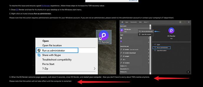

The Low value error prompt that you have experienced is “Low Value TDR”, we do have a comprehensive guide on how to solve this issue, although it mainly appears on file that are too heavy and empty files should be fine. Anyway, please visit this link and follow the steps thoroughly. What is TDR and how to solve the TDR(Timeout Detection Recovery) problem when rendering?

Thank you for additional tips. I tried changing the values of TDR even before, but the values kept going back to default setting. Couldn’t find a way of changing them so I tried downgrading my driver as you also suggested. It helped, my D5 started working again, but it affected other programs such as rhino in a negative way. I also couldn’t start AMD Adrenalin software so I just updated to the newest version of drivers and D5 started crashing again, but others programs worked without a fault. Also the issues I am facing are with a complete new project. When I try to load my previous project with models, textures and so on, it crashes just in the loading screen.
You need to restart your device after doing the steps that were mentioned in the link:
