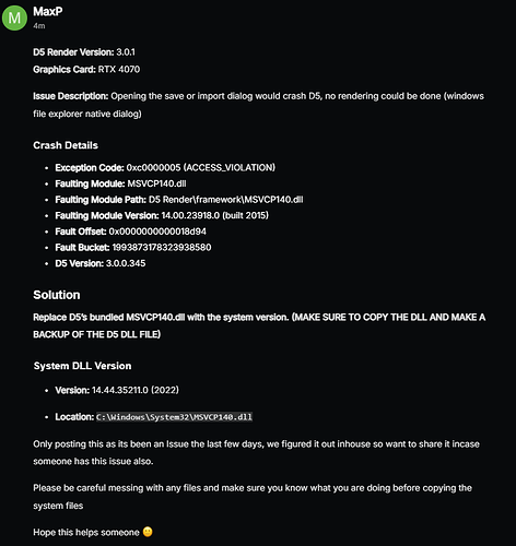

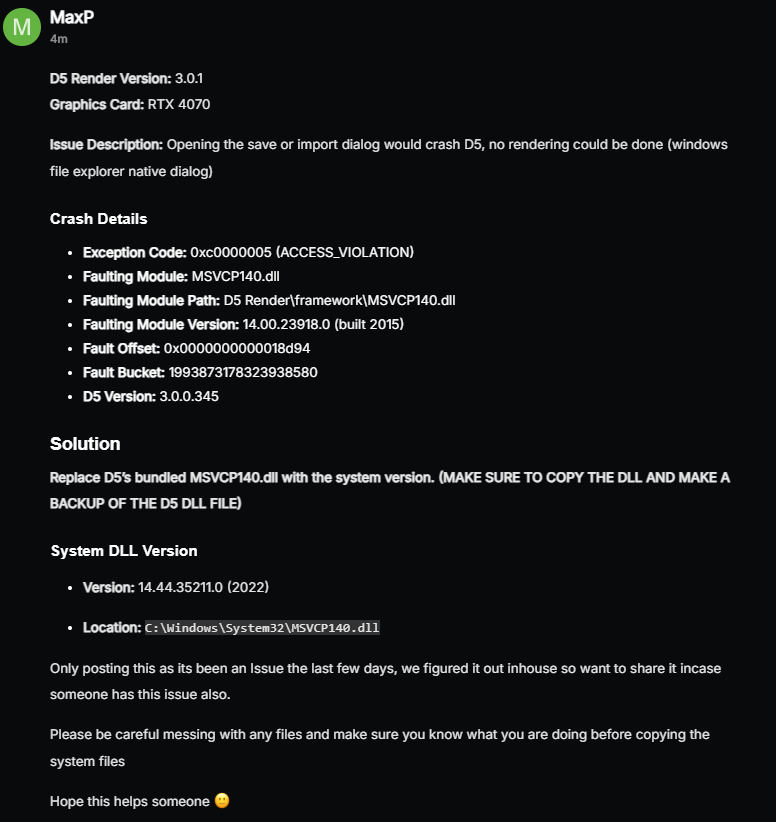

Hi @emir.yazici
I apologize for the inconvenience. This is currently a known issue and will be fully fixed in the next version. For now, please try this workaround:
  • Renamed the local files in the D5 \framework\ folder (MSVCP140.dll & _1.dll) to .old.
  • Copied healthy versions from C:\Windows\System32.
  • Pasted them into the D5 \framework\ folder.
  • Result: Crash resolved immediately on all machines
