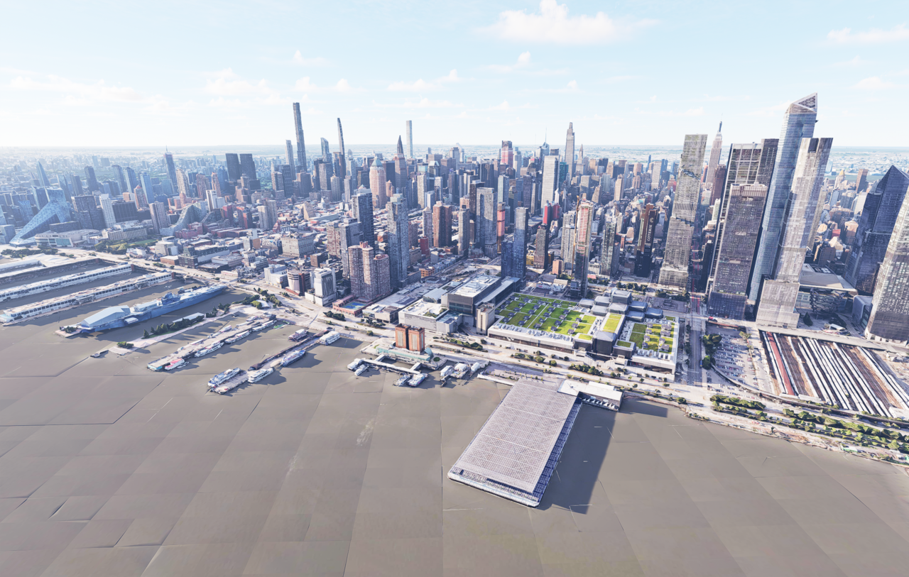

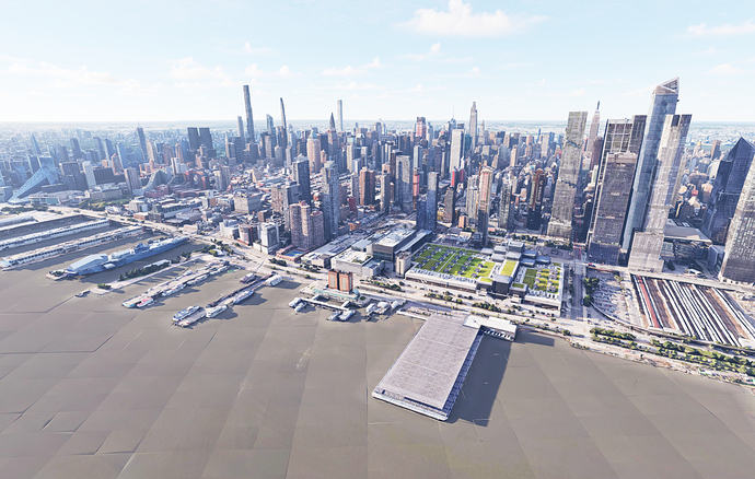

Issue Description:
I’m having a problem when trying to use Cesium. As you can see from the screengrabs the data seems to be leaving a visible tiling effect all over the mesh. I’ve watched Andy Christoforou YouTube video on installing, to ensure all installed correctly. I then went to the same space in Cesium and mine was looking different with the tiling where as his was absolutely fine.

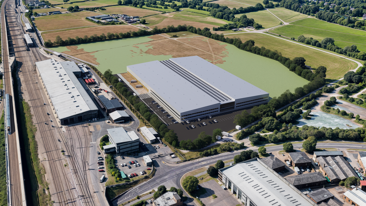

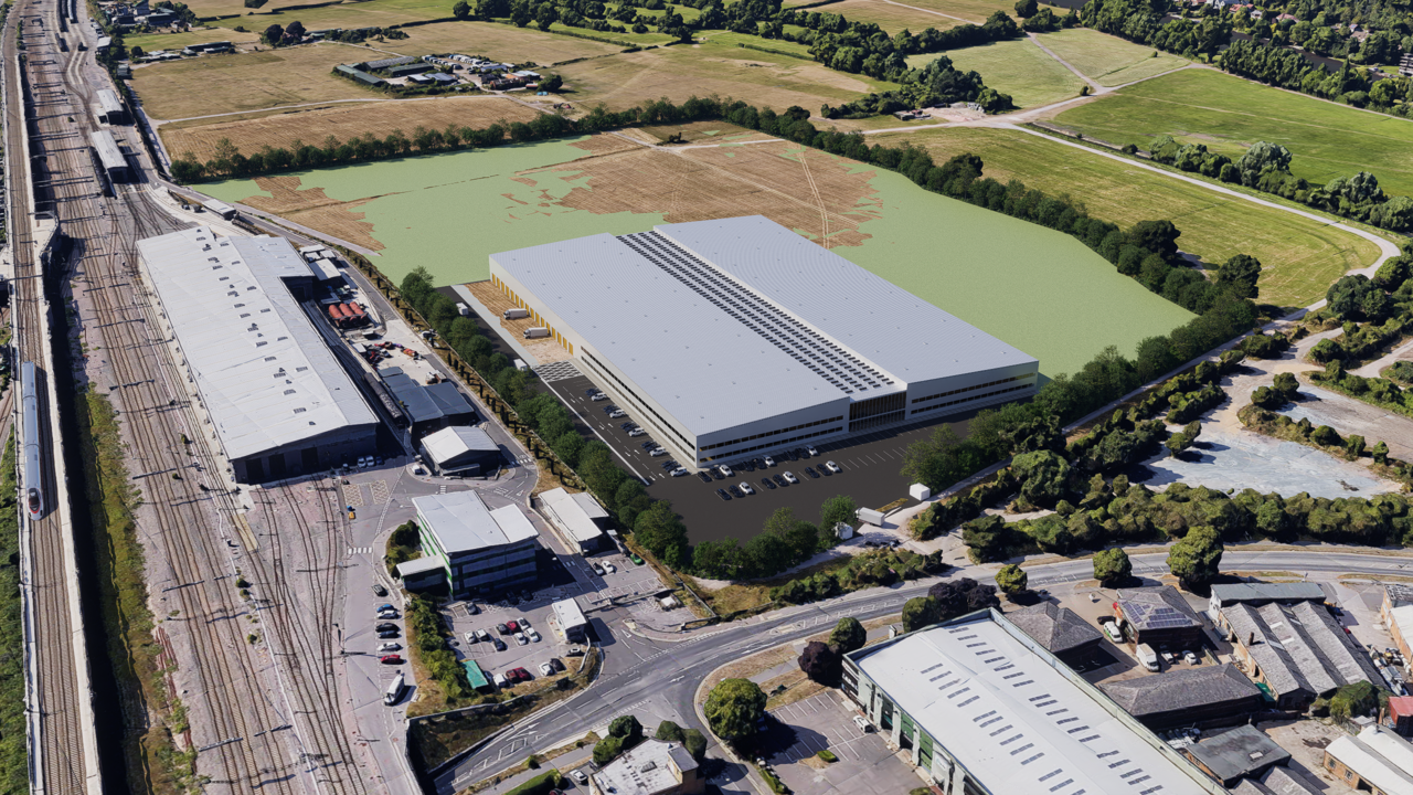

I have done a site specific rough test (ignore the fact the model and mesh overlapping, but you can see the tiling effect on the railway and in the fields. Yes I can improve these with some AI which i’ve alos attached, but I want to understand if it’s something I’m doing or a limitation of Cesium?
Any thoughts would be great.
Is this expected behavior, or is this something that shouldn’t be happening?
Hi @henry1
This is currently expected on our end. We will be further optimizing Cesium tool in subsequent release. Thank you.
