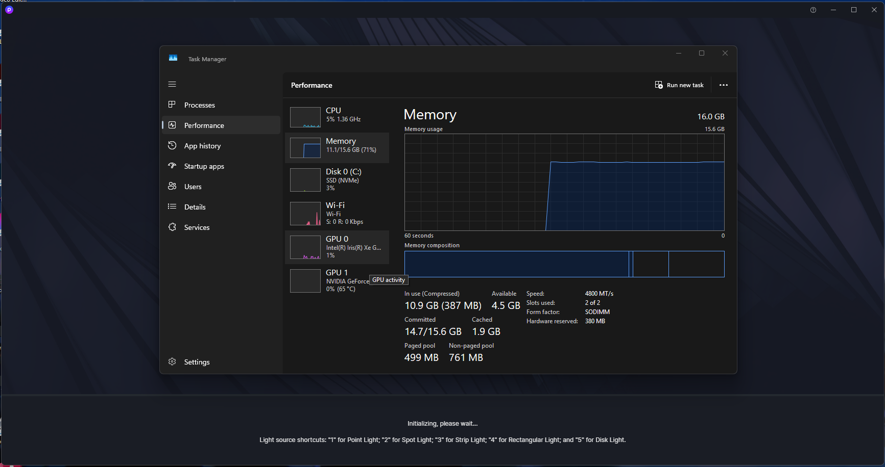

  • Please Use the Down Arrow to highlight Memory Speed
  • Press Enter.
  • Use the Right Arrow key to try to change it (If it cannot be changed let me know)
  • Once that is done, press the ESC key.
  • Press Enter on Save Change and Exit, and reboot the system.
  • Check if the Memory speed has changed through the task manager (the image I sent earlier)
Thank you for confirming. I tried it, but I can highlight and change the blue text on the screen, but I cannot change the black text. I’ve tried various things, but it doesn’t seem to work.

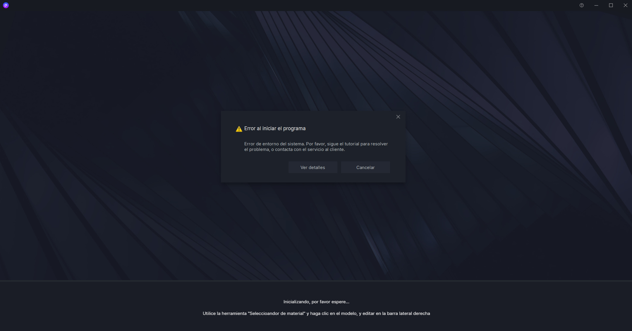

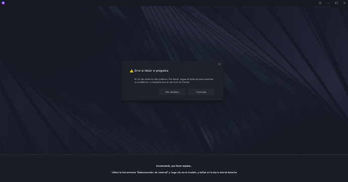

Hello, i have the same problem with the last version of D5 (2.11)
D5 Render Version: 2.11
Graphics Card: RTX 3060ti 8GB
Driver Version: 577.00 | WHQL
Issue Description: System environment Error
Hi @doc.mateo.arq
Were you able to download the launcher? If not, please do it in this order:
  1. Versions after 2.11 require the installation of D5 launcher before downloading - Please download the launcher first before downloading 2.11
  2. Open D5 Launcher > Click the download button on D5 launcher homepage, select the download location, download and install.
3

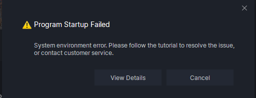

Hi, help?
Whenever I try to open a d5 file, the initialize screen would pop up, load for a couple of minutes then close on its own, and the Program Startup Failed notification would show.
I’ve updated my BIOS, graphics driver and windows update and reinstalled d5 multiple times, but the problem persists.
I tried opening from sketchup using livesync with a different file (I used a small file that is literally just a square to test) but Program Startup Failed still shows up. I’ve also used the system file checker but no changes

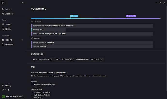

Here are the specs of the laptop I’m using:
D5 Render Version:3.00
Graphics Card: NVDIA GeForce RTX 3050 Laptop GPU
Memory 16G
CPU: 12th Gen Intel Core i7-12700H
Driver Version: 32.015.6607
System: Windows 11
Hi @danicaaustria741
Sorry for the inconvenience you’re experiencing. Could you please let me know the model of your laptop?
Also, have you tried Solutions 2 and 4 from our official troubleshooting guide? These steps often resolve the “Program Startup Failed” issue. Why prompt 'The program cannot be launched because of DLL errors...' or 'Program Startup Failed'? | User Manual
