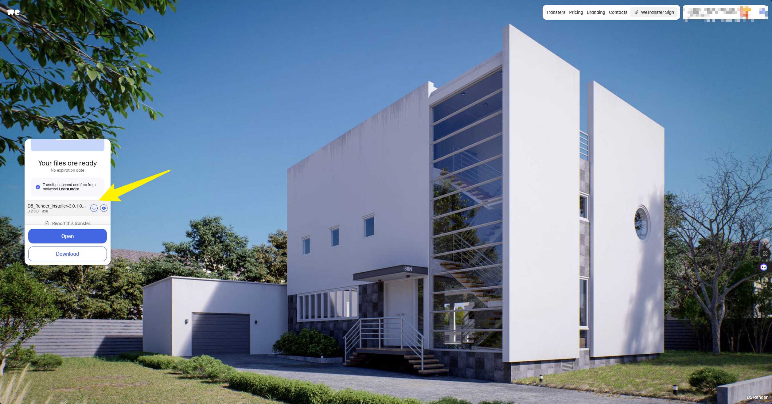

I tried to download the 3.0 from the site you sent, and it says the file is not available on site

The link I have provided will redirect you to a WeTransfer link containing the 3.0.1.0683 installer.
  • If this does not show on your end, please try to clear your browser cache or simply use another browser.
