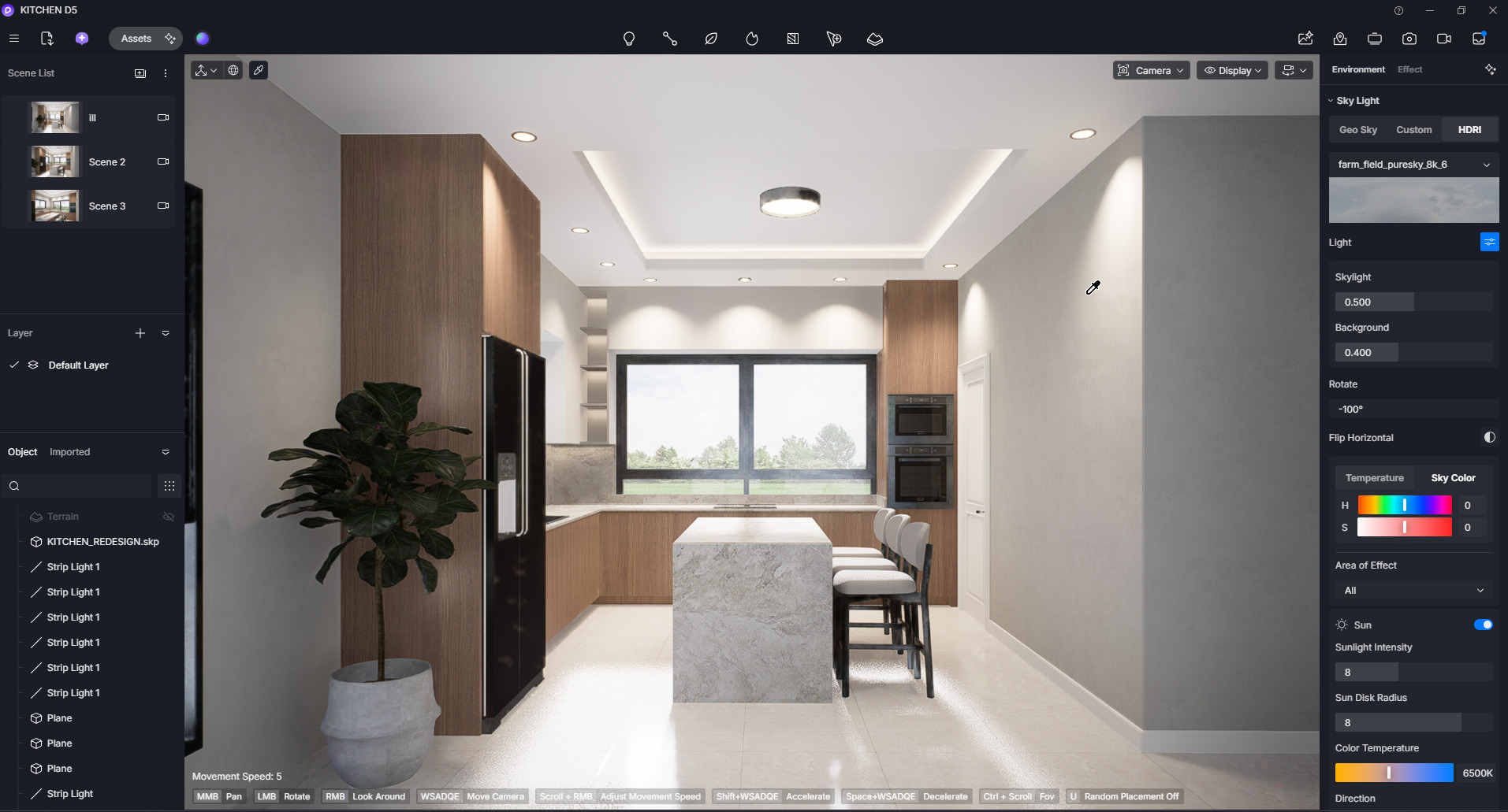

Good evening @ela I’m having problems with material picker, it doesn’t select the surface that I want to change it feels like it doesn’t read my model’s geometry because if I try to apply a spotlight it doesnt snap to the surface hope that you can help me! thank you!

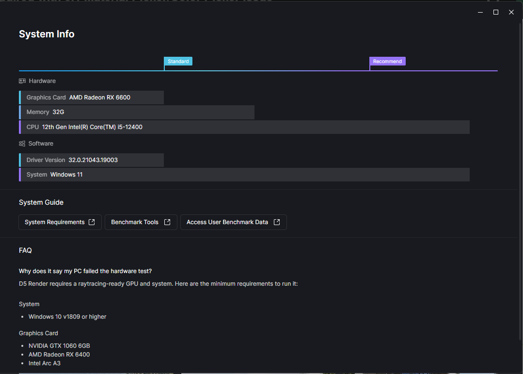

Can you please send us a screenshot of your System Information?
We’ve confirmed a material picker issue with AMD GPUs, these are the following scenarios, and do confirm if you fall into either on of these:
  1. For AMD 7000 series and AMD 9000 series 3.1 paired with the old driver version 2025.9.1, the color picker will fail to work. It is recommended that users install the latest driver to resolve this issue.
  2. For AMD 5000 series and AMD 6000 series, the color picker fails to work when using version 3.1 with all AMD drivers. For now, rolling back to version 3.0 is the workaround.

here is my system information
